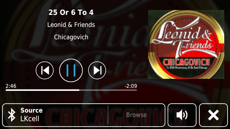

I was going to tell you about the problems I had trying to use my Galaxy S10 with MediaMonkey as my source for music through my XT to my Sena S20 and how it never worked and how I gave up years ago and how it is just easier to put mp3 files on the SD card in the XT even though I can never get the album art to display...
Then I thought I better double check the exact nature of the problems, brought my helmet inside with the XT and phone, and...
it's all working absolutely perfectly. :shock:
Title, artist, album, album art, cool background I never noticed before, play/pause, forward, back.
So all I can really say is, don't give up, because it should all work as you expect. I just don't know why it does.
Can't choose what to play from the XT, but I usually just let the player do a random shuffle of whatever is available.
