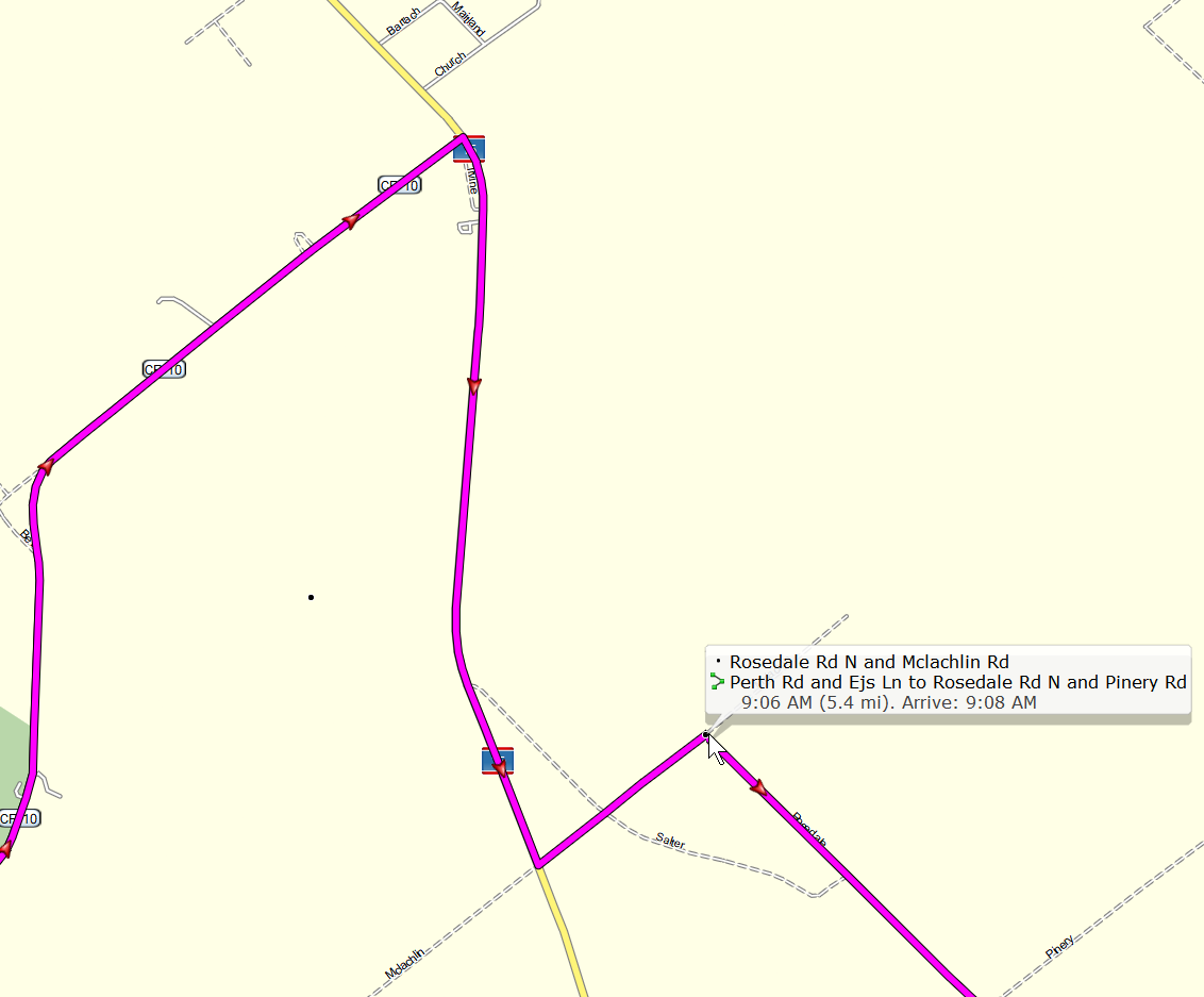

Re: Basecamp vs Zumo XT2 map
Thats very weird and can't recall a problem like that ever before. If something shows on the XT2 map it should show in BaseCamp. I'll try to have a look at that later on my BaseCamp.
Unfortunately I'm in France and my laptop doesn't have the NA map so can't look to see if I can replicate the problem but one thing you might check, although it's a long shot, is look in BaseCamp in Edit, Options, Activity Profile, Select map display features then Lines, Transportation. Ensure you initially select the routing profile you use, which I guess is Motorcycling? Ensure all road types are selected as it could be that part of the road has been allocated different attributes to the rest.
In Basecamp, go to Edit>Options>Activity Profile>General tab>Map display features. Check the box for Lines>Transportation>Unpaved.
You should be able to see McLachlin Rd at the end of Rosedale Rd.(N45° 00.823' W76° 02.785', for the curious)
If you still cannot route on McLachlin, open the route, Route Options tab, Customize Route options. uncheck the Road type avoidances box for Unpaved Roads.
An alternative, if you always wish to allow unpaved roads, is to make this change for all routes which use the current activity profile via Edit>Options>Activity Profile>Routing tab. That will recalculate all routes in your BC database using the profile.
I added the selected shaping point shown. Otherwise, depending on other points on the route, Salter Rd was preferred to reach Rosedale Rd.
Post by gwilki »
@lkraus That did it!!
I didn't think to do that, as McLaughlin is paved. In truth, I likely would not have thought of that anyway. :)
Thank you all for your help and input. I'm not as active here as many of you, but each time I've come here with a problem, you guys step up to help. I truly appreciate it.
I'm glad we found the problem. Although I posted the Google Maps link, I did not really look at the road to see that it was actually paved. Map errors like this can be reported to Garmin or directly to their map provider, Here Technologies.
I also find it helpful to have alternate maps available for comparison. I see now that the Open Streets Map for that area does show McLachlin as paved, and allows routing on that road.
