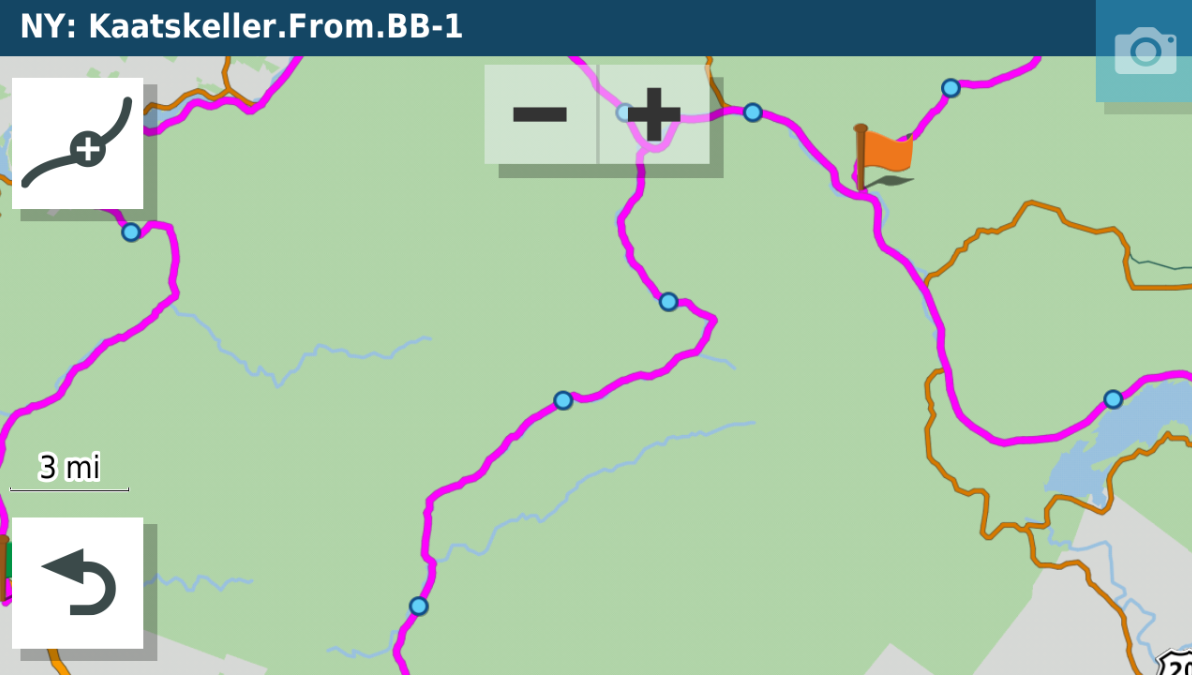

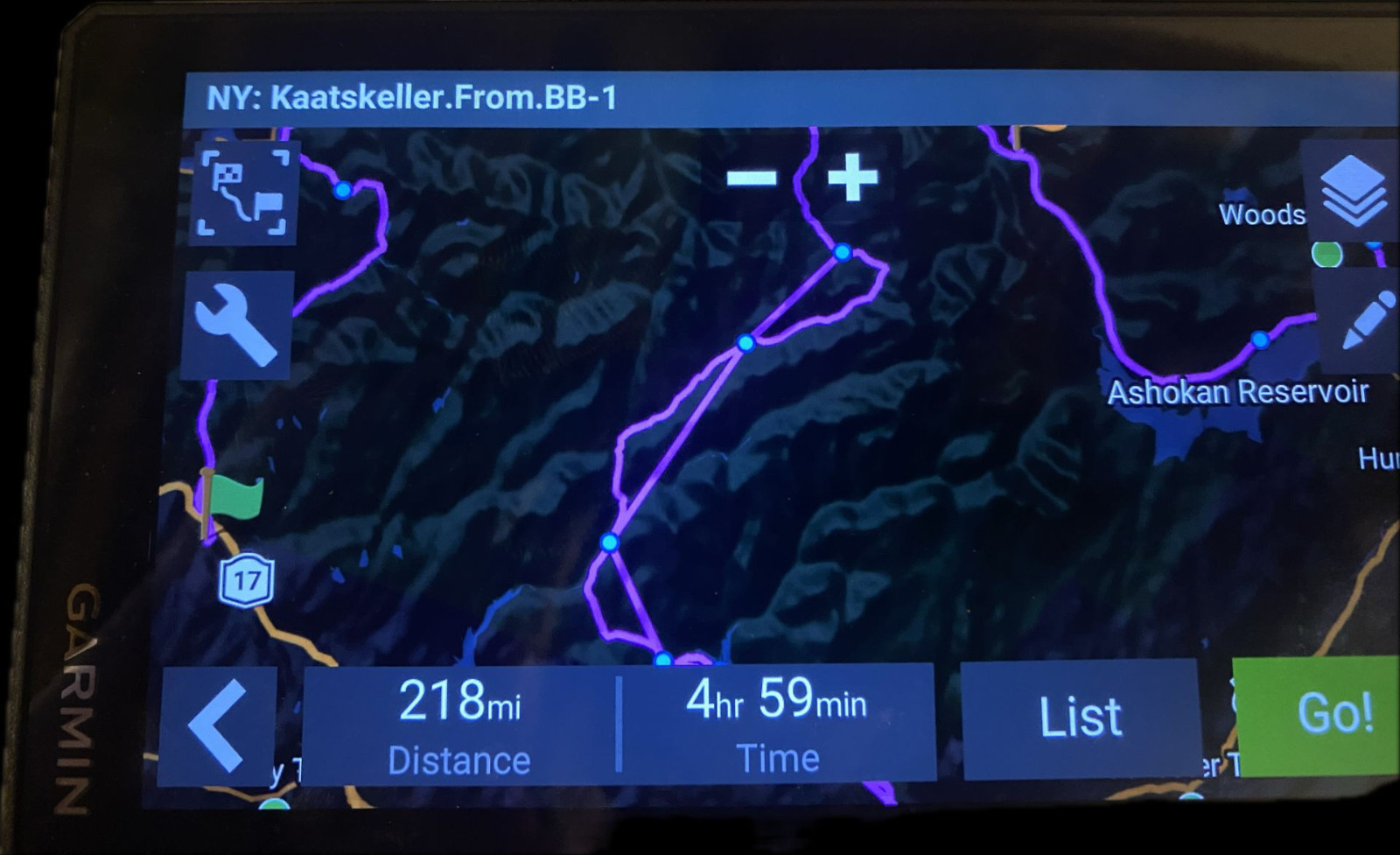

I have another question regarding a route I created on Basecamp. Can anyone tell me why the following route doesn't display correctly on a Zumo XT2? The route displays correctly on a Zumo 595 and in Basecamp. I actually have a couple of routes that don't seem to display correctly on the XT2, that were created with Basecamp. Part of the route appears as a straight line along with a curvy line of the actual route. My guess is this is a bug.

My XT2 displayed exacly the same results as yours. I thought at first it was because the end point was plotted off route - but that isn't something that I had seen before. I changed the next to last point to a Via - and that got rid of it. But then when I imported it again the probelme reappeared.

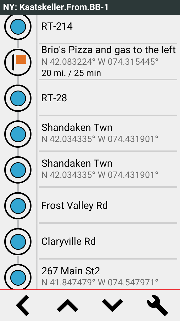

So I looked at the list in the XT 2.
Look what I found:

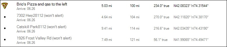

Compared to the Basecamp list :
Shandaken Twn is the name that XT2 has allocated to Catskill Park8112. The coordinates are the same. But it has put it into the route twice.
You wouldn't notice this just by looking - the route list shows a number of locations names twice - but they are roads and the points are in different positions.

So I created a track of the route and used it as a reference to see what happens if I deleted the Catskill Park shaping point completely. It stayed the same. And when I sent that to the Zumo XT2 - it looked perfect.
Don't ask. I haven't got a clue. I don't know if that straight line is a branch or if it is the same route coming back. I've yet to try to simulate the route from Brios Pizza and Gas to see what it looks like to navigate - and which route it takes.

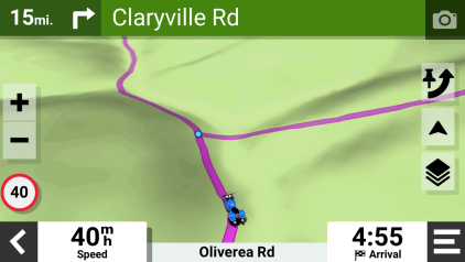

Following on from my answer above, this is what the navigation screen looks like when the satnav is approaching the Shaping point with the extra route tagged onto it. The straight line rought is the one to the right. Undser simualtion, the satnav doesn't even recognise it as a junction (look at the distance to the next turn in the top left), and it carries on across that junction without pause - as if it isn't there.

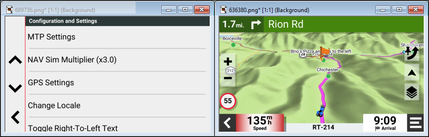

Double Route Line on Importing BC GPX route
Simulate Routes at Extra Speed
The XT2 has a new feature in the hidden system menu. You can modify the speed of the simulation so that the motorcycle travels faster. From normal speed up to 3x speed in 0.5x increments.
When I tested it, I had to set the speed AFTER I had started the simulation. But that may or may not be necessary every time.
To access this feature. Long press the circular speedo after tapping on the map's speed button.
Select Configurations & Settings -> NAV Sim Multiplier
Each press increases the multiplication factor - in a cycle.
Back out and the simulated navigation will continue running. Note the speedo.
Some Screen shots:

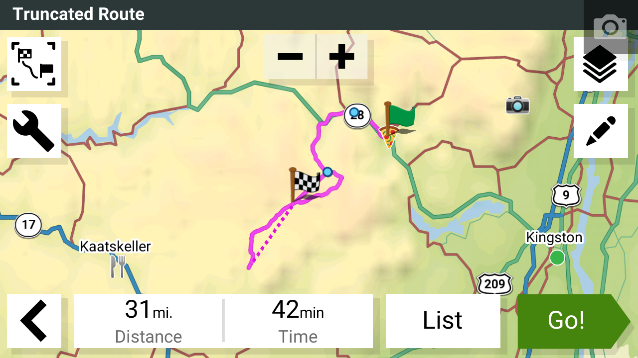

I tried shortening the route - deleting the route points before Brios Pizza and keeping only the following 4 route points.
