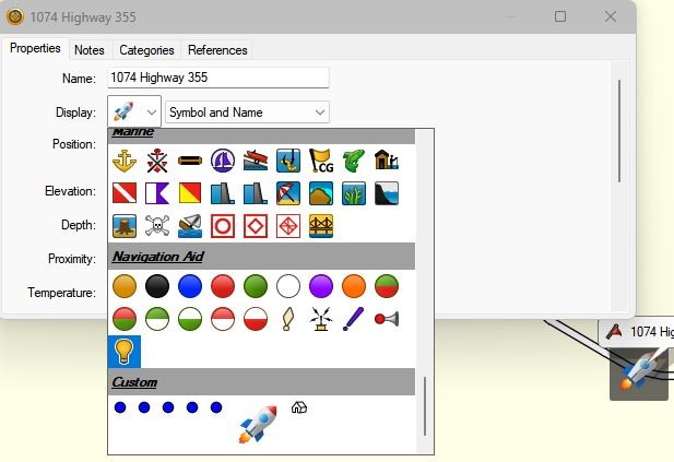

If I create a random waypoint and Open it for editing, then scroll to the bottom of the available icons, there is a Custom section with eight blue dots. I think these are just placeholders. If I replace one with another small .png file, the change will show after restarting BC. Filenames apparently have to remain 000.png to 007.png. Sizes from 16x16 to 48x48 seem to work, I did not try larger or smaller.
