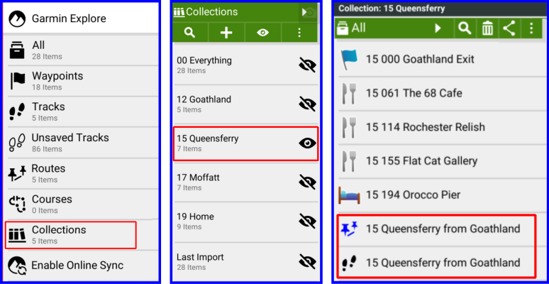

The Explore Icon
Nothing to be wary of here. This opens up a new way of managing the tracks, routes, courses and waypoints on the Zumo - terms which we are familiar with if we have dabbled with Explore on the XT, but what I can only assume was an experiment on the XT, now seems to be a fully-fledged solution for organising routes, tracks and waypoints no matter where they were created. And unlike the XT, it doesn't need to be synched to anything to use it.
For these screen shots, I have not made the link between the XT2 and the Explore database.
Click the image to see a larger version.
Collections
The screen on the left of the above image is actually obtained by tapping the green bar on any of the Explore screens - and shows what kinds of data are managed by this utility. From here I selected collection.
The next images shows the collections that created - 1 collection for each day of a small tour that we did a few years back. 15 would have been the 15th September. Note that Queensferry is the only entry that doesn't have its eye icon (eyecon ?) crossed out. Only the queensferry tracks and waypoints will show up on the map.
The next image shows all of the data items that I have placed in this collection. The Exit - the first Via point to pass through after setting off, 3 cafes, the final hotel, a route and a track. All collected together in one place.
At the top of the previous image is a colelction called '00 Everything'. As well as belonging to a collection like Queensferry for the day, I have added everything to the my Everything Collection. I didn't need to - there is an option to show 'All' in the first screen !

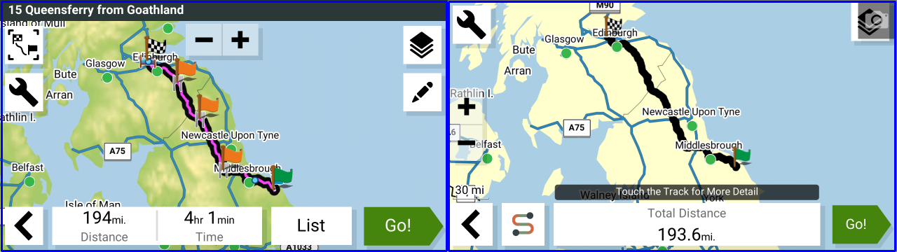

The above image shows the route screen and the track screen. The track screen is shown on the right. On the left is the route screen, showing the magenta route, the start, finish, three Via points and a couple of shaping points (small blue discs). But it is also showing the track peeping out under the route.

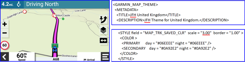

The above image shows the route in progress (under simulations on the XT2). Out of the box, the route and the track are the same width, and you rarely get to see it to confirm that it is there. I have edited one of the standard theme files to make the track wider. I took a copu of the United Kingdom theme and edited it in notepad. The changes in the top box are at the start of the file. The changes in the bottom box are located near to the bottom of the file. 3.00 might be a bit wide. I've used 2.00 in the past on the XT and it is not quite enough.
What I haven't mentione in all of the above - all tracks and waypoints can be sorted into different orders. By Name, by proximity (where appropriate); latest first. I get round the lack of ability to sort by date of trip by including the date in the name.
