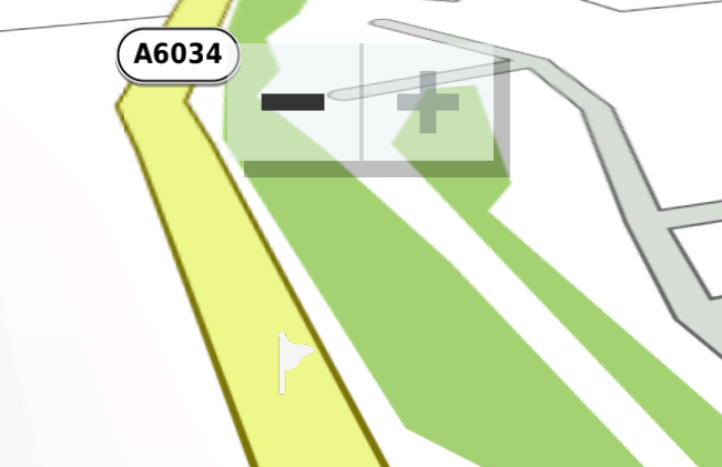

Up ahead places needs to be ticked to show the CustomPOIs. At the time of doing this, the POI shows up as a tiny white flag which is almost invisible.
The image below is a screen shot zoomed in to the max. It is slightly easier to see when it is on a magenta route, but it is still not great. I am going to take a look at the map theme to see if it is possible to change this. It may be better if Explore is set up. I don't know.
It is there, honest - middle of the yellow road, just up from the bottom.
[edit]- so far I haven't found anything in the theme that changes the custom poi colour. Maybe it has to be declared in the POI file itself - I know that you can display pictures and play sounds. Perhaps you can specify an icon.

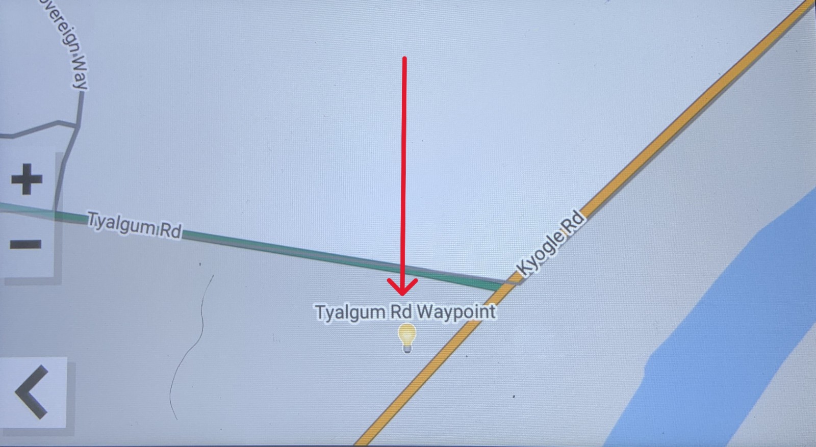

Photo 1 shows what a new Waypoint looks like on my XT2 screen. (Red arrow has only been used to highlight the Waypoint)

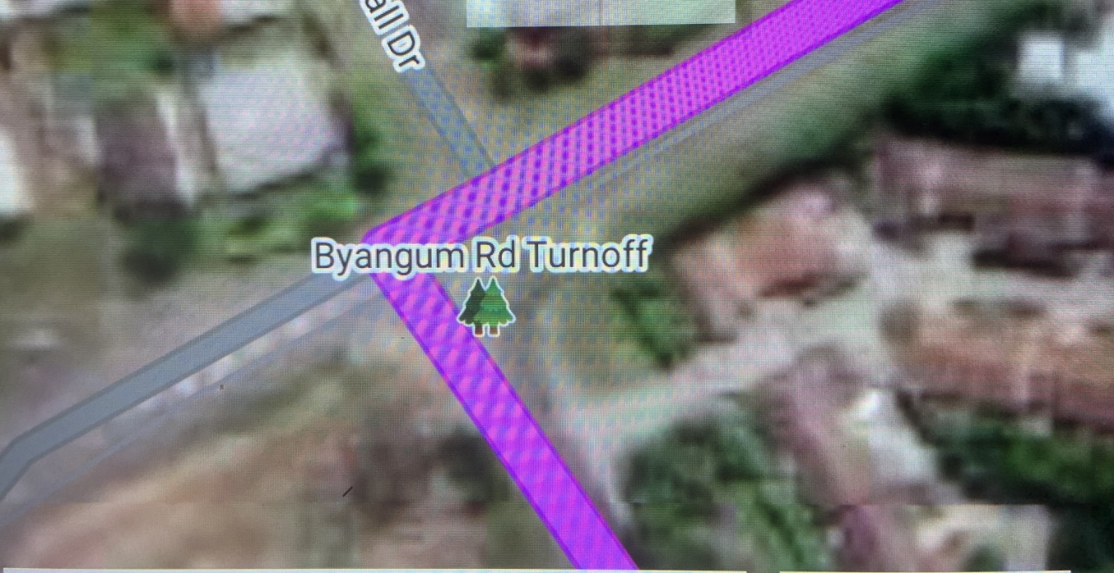

Photo 2 shows what a Waypoint looks like when using BirdsEye view. In this example I've used a tree icon for the Waypoint
Hopefully this info might help you. :)
