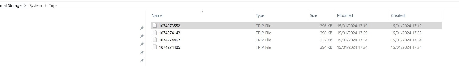

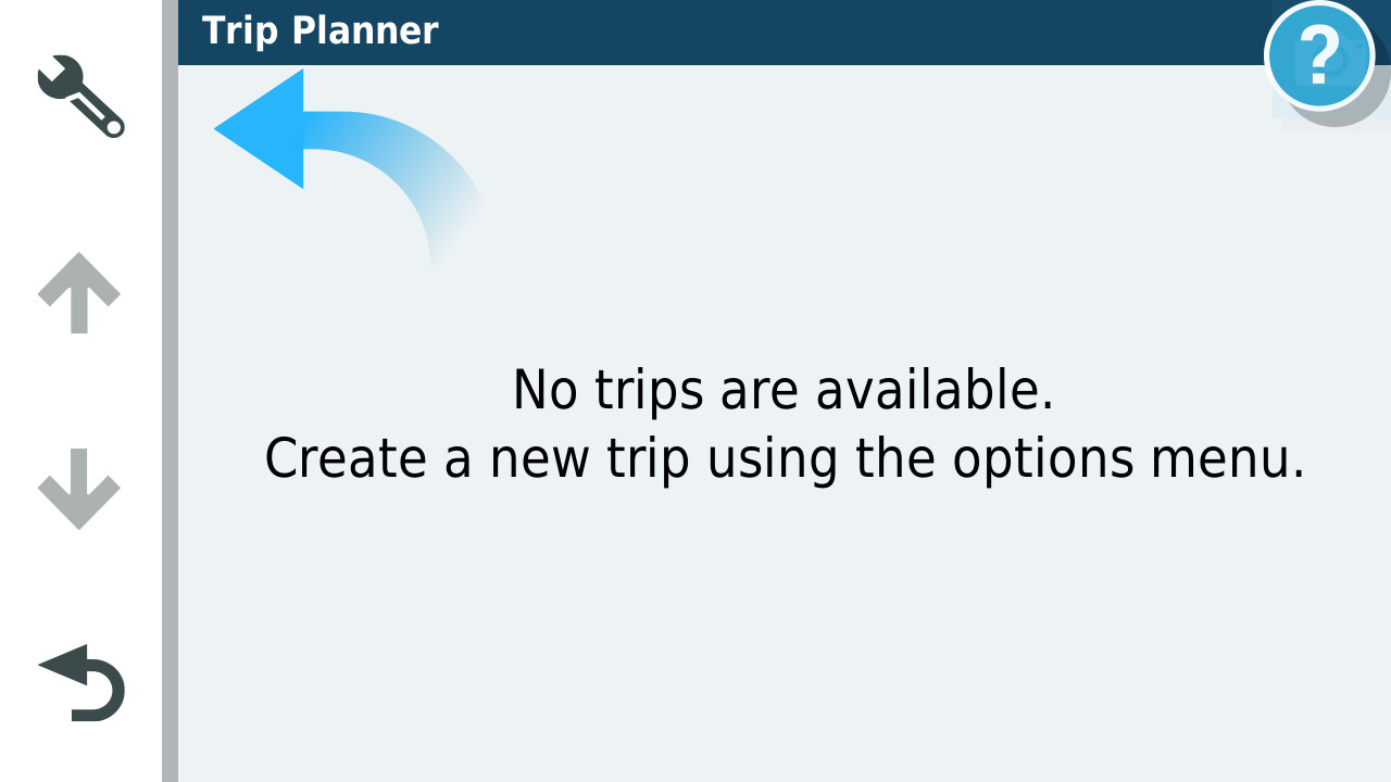

Okay, having enabled the system directory (as above), I can see there are 4 files in \trips...
Garmin XT Trips.jpg (31.97 KiB) Viewed 1748 times
I suppose the time stamps on these files show the failed attempts.
Having captured the screen shot, I disconnected the XT, re-booted it and then attempted to create the route one more time. Sure enough, there's now five trip files, but still nothing in the Trip Planner.
Re: Problem uploading a specific route to Zumo XT
The XT appears to be completing the import process. I'm at a loss to explain why the routes aren't appearing in Trip Planner. I hope someone comes along who has a clue.

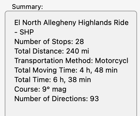

Very interesting, and puzzling. The Mac version of BC does not use the term "points," but I'm wondering if instead it is "Directions." If yes, this is a decent measure of complexity. Here is my previously-mentioned 240-mile route's info:
Screenshot 2024-01-16 at 8.11.11 AM.png (43.92 KiB) Viewed 1719 times
My next guess is about the trips files in your system folder. Did they survive the reset? If yes, try deleting them. Does your route by any chance have a very long name? If yes, those existing files may cause trouble when the XT tries to add the next upload attempt and append a "1" or higher number to the end of it.
Wild guesses, but just in case they help.

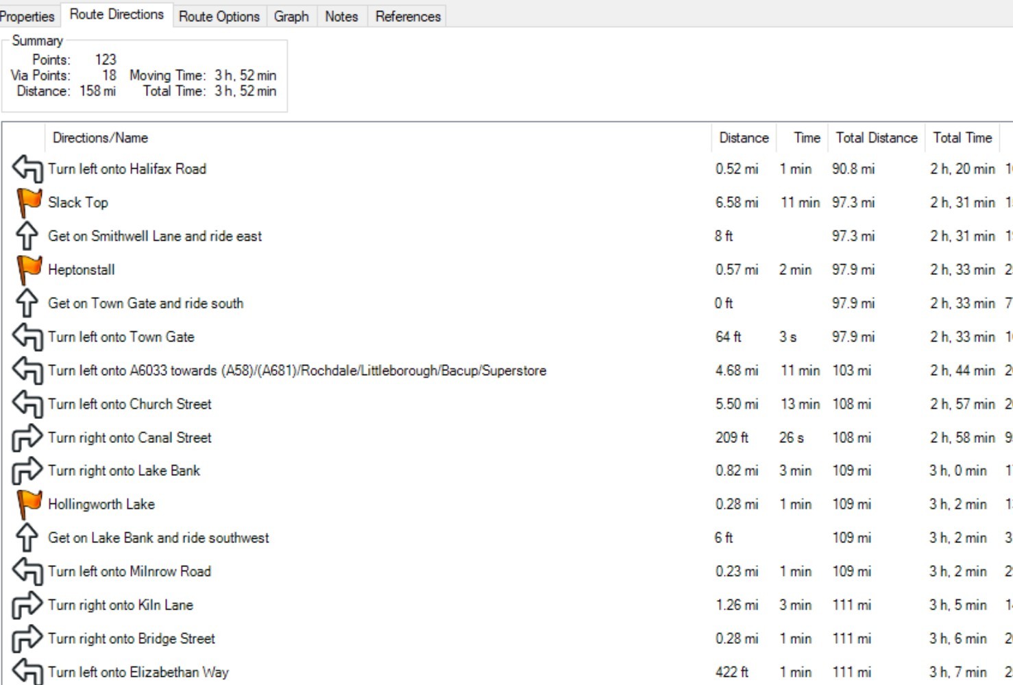

I think you are probably right, the "points" is probably the number of detailed "directions". At the level of detail shown, I'd guess there are around 120 detailed directions in my route...
HB Detail.jpg (163.66 KiB) Viewed 1711 times
As far as I know, that is not something I can control, and is probably a function of the complex old road system we enjoy here in UK. :D
