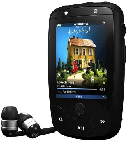

I had a situation years ago with a Slacker Radio. The family and I caravanned with a number of other family members from Minnesota to Missouri for vacation (holiday). I had the Slacker Radio powered by a 12 volt charger with a USB port playing in our van. The Slacker radio powered up and played for hours, but then stopped. I found out the USB charger was rated at 500 mAh, but the Slacker Radio needed a minimum of 600 mAh to charge!
