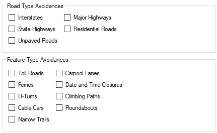

3. Whatever routing preferences are set in Basecamp - ie this little lot:
BC Avoidances.jpg (19.64 KiB) Viewed 1578 times
.... the XT completely ignores them. Why ? Because none of them are sent to the XT in the first place - so the XT doesn't have a clue what avoidances you set. But the XT does have the complete route identical to the one that Basecamp created. And BC used the avoidances to calculate the route. So providing the route deosn't recalculate, your route will avoid whatever your BC route avoided.

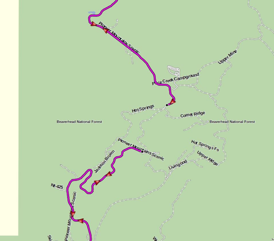

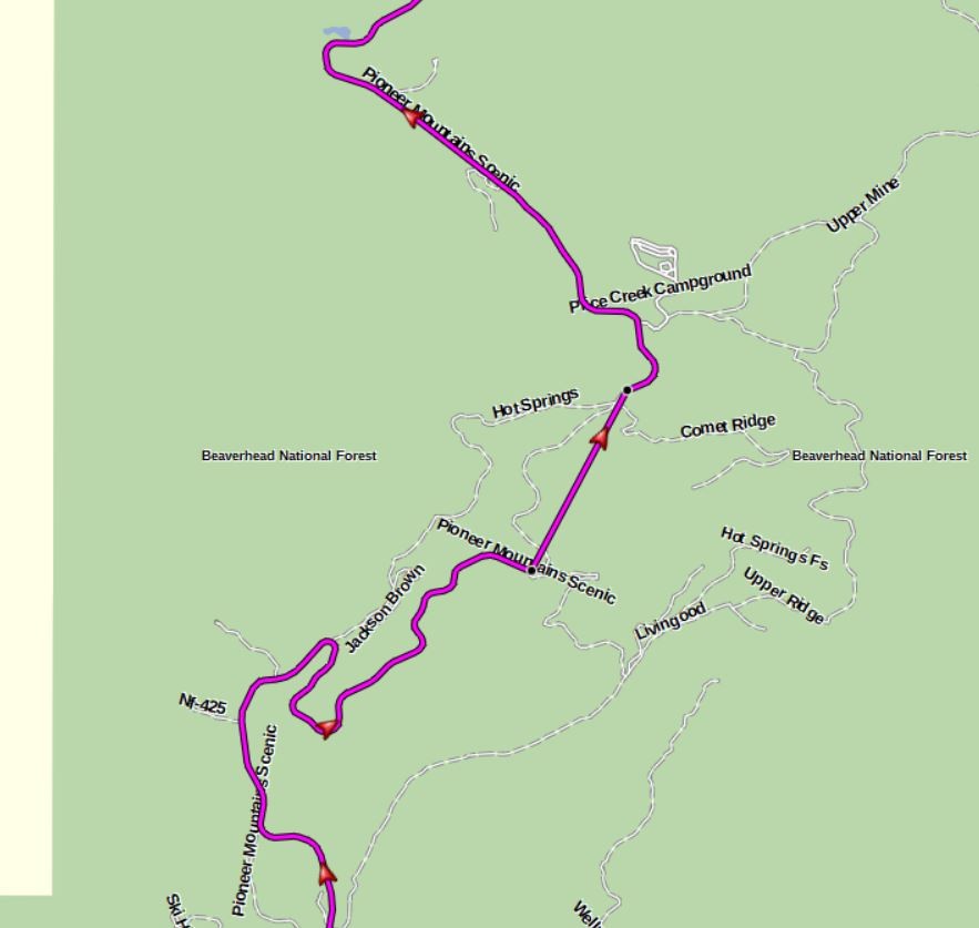

An alternative method can be to use one or several Direct route points. Basecamp and the XT then ignore the street conditions following the Direct route point up to the next route point. This is at the expense of the route line not following the road. The images below show traversing an unpaved section by using a shaping point at each end of it and then setting the first one as a Direct point. Route direction is riding North.
This first image is without a Direct shaping point. The route calculates to the shaping point from each direction then u-turns.
The second image shows setting the first (southern) shaping point as a Direct point.
The third shows the results after recalculating.
Obviously you can use additional Direct points to create turns in the section you are trying to route direct over.

Basecamp MT 01.JPG (56.5 KiB) Viewed 1567 times

Basecamp MT 02.JPG (96.96 KiB) Viewed 1567 times
Basecamp MT 03.JPG (55.68 KiB) Viewed 1567 times
