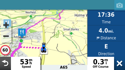

OK - So I went out today, but ran out of time - it had to be the car !
I loaded a track created in Basecamp from a route - using roads that I had no intention of taking. And then transferred the track to the XT.
Loaded the track and selected Go!
The above is typical of the entire 6 mile test. Deliberately off route int he shot above, the dotted line heads for the point closest on the original track. The blue flags are the 'Up Ahead' places which I normally have turned off, but thought I'd turn them on for this test. It also shows favourites as greenhearts - but not in this shot.
Nevertheless the banner remained empty for the entire trip. Note the Off-Course button, bottom right. Easily put in place if it is not there.

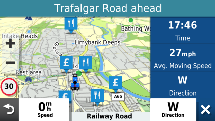

This was the screenshot when I fell off the end of the magenta 'Track-Go' - note that the Banner is now telling me what is up ahead !
This is different from my previous observations - which unfortunately I do not have documented (at least I can't find anything).
Aside. Something I said earlier now seems to be incorrect. I said that the calculation was working out which way around a roundabout the magenta line should be plotted. I know that this is what I observed ages back, but this is no longer the case. I plotted the originla route the wron way around on Basecamp. On the XT, no matter whether I selected 'Start to Finish' of 'Finish to Start', for the way I was traveling, it plotted the wrong way round the roundabout. So unless my observations from earlier were wrong, then this is changed behaviour. Not that it matters - the magenta line is close enough since it isn't issuing instructions.
Perhaps my earlier test was for a track converted to a trip, and my memory is confused ? WHatever, - it does not calculate the Track-Go magenta line taking into account the side of a dual carriageway or the direction round a roundabout.

I appreciate you giving it a test. I didn't have a chance to get out today but likely will tomorrow.
I want to try a few variables and see if anything more that might help decipher my predicament. Or my reporting.
I don't believe I've ever had a blank banner. For a track or a route. Hmmm.
I'll look into the off-course button. What does it say if you are on-course? Does it revert to another pre-determined thing?
What precisely did you mean when you say you fell off the track entirely? I will try to emulate that just for grins.
I'll also try the Start to Finish, Finish to Start thing, too. Why would it even be there?

No problem at all - I wanted to know myself. When. i first tried out this method of navigating, I was surprised how much I liked it. Following the route that I plotted, no recalculating, no instructions, but
a vague finger point 'You need to be over there somewhere' if you go off route'. Really quite relaxing.
BradB. wrote: Wed Nov 22, 2023 1:05 am I don't believe I've ever had a blank banner. For a track or a route. Hmmm.
No - it looks odd to me too.
BradB. wrote: Wed Nov 22, 2023 1:05 am I'll look into the off-course button. What does it say if you are on-course? Does it revert to another pre-determined thing?
No, it remains there but shows dashes instead of digits for the distance. You will notice that in the second shot, the Off Course button has gone. I didn't do anything - except I had reached the end of the magenta line, so the trip data in those 4 locations on the right of the screen changes to what ut was before I selected Go!
BradB. wrote: Wed Nov 22, 2023 1:05 am What precisely did you mean when you say you fell off the track entirely? I will try to emulate that just for grins.
Sorry - Yesterday, I knew where I was going and I plotted a track which started after I had set off and finished before I reached the end. When I set off, I got a dotted straight line pointing to the beginning of the route. When I reached the end of the magenta line, I still had a but further to travel - So I had continued driving after I had reached the end. I 'fell off the end of the line'. That was when the second screen shot was taken which shows no magenta line and the banner had a caption.
