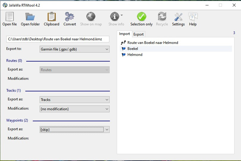

I've tried your method and it works. I like new viewpoints on creating routes/track, and your post is certainly a new viewpoint. But for anyone who dislikes modifying the track with Notepad, here's an alternative to the manual editing as quoted.
You can use Javawa RTWTool, that you can download from: https://www.javawa.nl/rtwtool_en.html (See also: viewtopic.php?t=2376)
Note: You open a KMZ/KML file directly in that tool, you dont need to convert it to GPX first with gpsvisualizer.
See the screenshot how you can use the tool to achieve the same as with your manual editing.

FrankB wrote: Tue Jun 27, 2023 6:34 am You can use Javawa RTWTool, that you can download from: https://www.javawa.nl/rtwtool_en.html (See also: viewtopic.php?t=2376)
Sorry for the late reply but me and my friends did a really long trip around EU.(6 000 km for beginners like us was a pretty big trip). And after the trip I got all caught in work...
Your advice sounds intriguing and I will try that for sure. It seems even easier with this Javawa RTWTool :)
