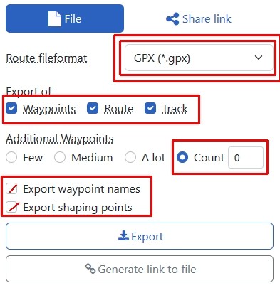

I cannot test this out as being suitable for the XT and the 590/595 without paying the subscription fee - so I wonder if someone who has a subscription would be kind enough to send me a couple of GPX files please ?
The export screen shot is shown below.
I would like a route with a few shaping points and a couple of Via Points - in addition to the start and the finish.
Waypoints, Routes, Tracks ticked and extra Waypoints set to 0.
The options that it will not let me select are Export Waypoint Names and Export Shaping Points - and these are the ones that I want to check out.
There are a couple of route file formats that might be suitable for the Zumos - "GPX" and "Garmin Shaping Point GPX".
So the same route exported in both of these formats would be brilliant please.

I do see "Try for Free" buttons: https://kurviger.de/premium/en.
Sorry, I don't have time right now to set up an account and see what the trial limitations might be.

Thanks @lkraus - Yes have the free version - which doesn't have the functions that I want to test. I don't fancy giving my credit card details for the free trial of the tourer edition just to try this out. In theory they do not charge for the first few days, but I don't know who they are...
If anyone already has an account and are willing to send a gpx, it will save me that hassle.

Check PM, samples below.jfheath wrote: Tue Aug 29, 2023 12:57 pm There are a couple of route file formats that might be suitable for the Zumos - "GPX" and "Garmin Shaping Point GPX".

1. No it only shows the route points - the route has to be calculated by the Zumo
2. Yes the waypoints are declared at the head of the gpx file, as well as being shown in the route. They do appear in favourites.
3. All shaping and all vias are properly declared One route had all Via Points. Other route had 3 Shaping points.
4. Both routes kept the names that were given in the gpx file.
5. Both routes were treated as Imported in the XT.
Additionally - all route points were declared as Waypoints in the file - and therefore appeared in Favourites.
Both routes were calculated by the XT on import.
The track data is correctly formatted and appears without the need to import in the tracks app.
Many thanks to @Zumek for supplying the files. Now we know. I'll fill in the missing results once i have loaded them in.
