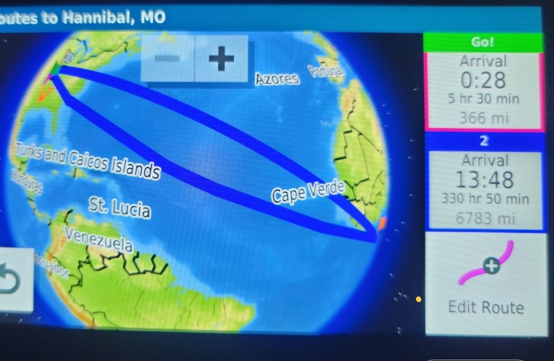

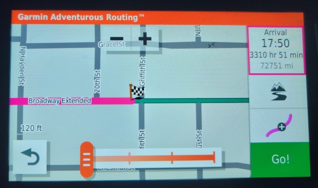

I have lurked this forum for quite some time but finally registered. The thread title caught my eye as I had a similar experience in mid Apr. I was in Rogers Arkansas and was figuring out my route from there to Hannibal Missouri. I was just using the XT directly to figure out the choices. First I wanted to see adventurous routes and this is what it gave me.
That kind of surprised me... Next I tried just letting it create a regular route. Choice 1 was reasonable but choice 2 had me traveling to Western Africa and then back

Too bad we don’t get free airline tickets and shipping with our Zuni purchase. Seems like a nice adventure!
