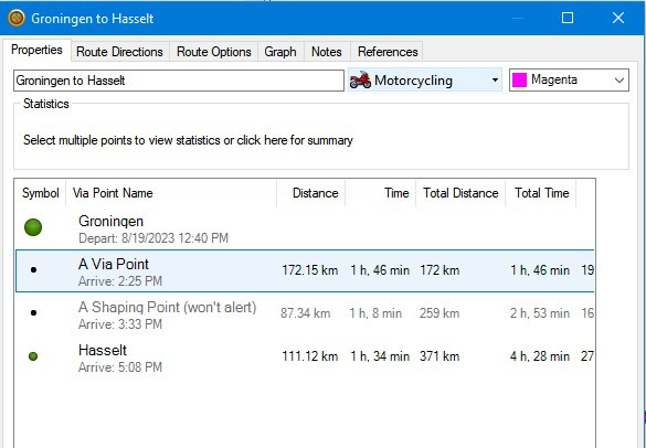

Maybe this is superfluous, but just to be sure.
You can tell the difference in Basecamp by opening the route (Double click on it) and look at the Properties. If you see (won't alert) next to the name, then it is a Shaping Point, else it is a Via Point.

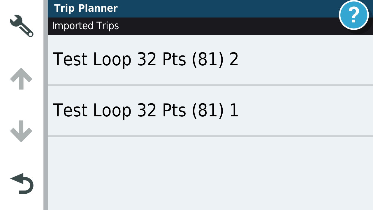

I decided to test the 29 via points versus 30 via points behavior.
I created routes containing 29, 30, 31, 32, 33, and 34 via points. In addition to the start and end points, I included one waypoint set to alert upon arrival. The routes contained no shaping points.
I imported each route individually. The routes containing 29, 30, and 31 via points imported correctly and no special message was generated. The 32 via point route (and those containing more than 32 via points) all resulted in a message similar to the one shown and the route was split into two parts.
32 Pts Msg.png (82.64 KiB) Viewed 1321 times
32 Pts Files.png (70.9 KiB) Viewed 1321 times
So while it may be possible to import a route containing 30 via points, based on the error message shown, I suggest using routes containing no more than 29 via points as this seems to be the maximum number the Zumo XT expects based on the onscreen message.
