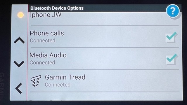

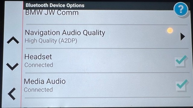

Hi - I just bought a Garmin ZUMO XT2, but am guessing I am making a user error XT users can help me with as well.
I use the XT2 with an iPhone, on a BMW GS 1250 R, and a CARDO bluetooth enabled helmet. I set up the ZUMO, made all the bluetooth connections required, I can hear the music via the XT2 in my bluetooth helmet, I can hear the navigation instructions through my helmet, BUT no phone calls. Each time I attempt to make a phone call via the ZUMO, it switches to the iPhone for less than a second (so it does send a signal), but then just disconnects. For additional information, the ZUMO XT2 is properly bluetooth connected to the Tread app, bluetooth connected to the CARDO helmet headset, and the iPhone as well to the helmet headset. Can someone please help me, figuring out why the phone calls are not working? I have attached the screen shots showing that all bluetooth connections are properly in place. Thanks!!!
