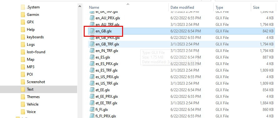

Re: Customising the warning screen
I haven't been able to figure this out. I can not find a file that starts with "en" (English) that contains the entire text displayed in the warning screen. The file en_GB.gbx contains about half of it but I have not been able to identify the American English file. In en_GB.gbx I couldn't identify where the word "Warning" at the top or the "Agree" button come from. Perhaps they don't appear in the UK version. Regardless, I am curious whether it is just the center text that can be changed.

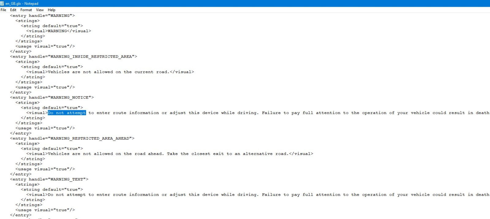

The words 'Do not attempt' can be found in the 'En_GB.glx' file. It looks very much like XML format.
In another forum I have read that the file (possibly) gets overwritten with a firmware update.
<off_topic>Still hoping for a firmware update for RUT! </off_topic>
do not attempt.jpg (147.11 KiB) Viewed 4337 times
Thanks @FrankB . I was searching for the "WARNING_TEXT" tag instead of "WARNING_NOTICE".
It appears that both the American English and British English language options use the en_GB.glx file.
FrankB wrote: Mon Jul 17, 2023 6:13 pm In another forum I have read that the file (possibly) gets overwritten with a firmware update.
I'll bet you are right based on its date/time stamp of 21 Sept, 2022. That is more recent than the purchase date. There are newer .glx files though so it appears that they indeed can be replaced. It is doubtful that a firmware update would replace just the modified ones so, although I like the idea of it displaying contact information, I now wonder if it is worth the effort considering it may change.
@Peobody
You're welcome
Btw: The text appears twice, as you can see in the screenshot.
