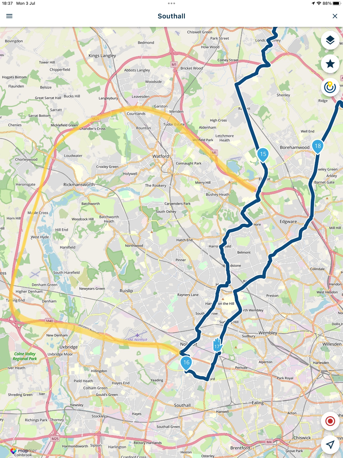

Here’s an interesting routing by the XT. Today I was going to Southall in London and had used MRA to plot the route. I deliberately left out some shaping points in London as traffic can be a nightmare and the XT usually deals with that. But today it took me to number 15 on the image then took me via the yellow line to number 16! As I was a bit geographically displaced at the time I didn’t realise it was taking me away from where I wanted to be! It presumably thought that was quicker than the MRA route but who knows?

Did you use gpx 1.1 or 1.2?Fourbears wrote: Mon Jul 03, 2023 5:43 pm Here’s an interesting routing by the XT. Today I was going to Southall in London and had used MRA to plot the route. I deliberately left out some shaping points in London as traffic can be a nightmare and the XT usually deals with that. But today it took me to number 15 on the image then took me via the yellow line to number 16! As I was a bit geographically displaced at the time I didn’t realise it was taking me away from where I wanted to be! It presumably thought that was quicker than the MRA route but who knows?
1.1 as 1.2 doesn’t work as it strips out all the points and produces straight lines. Been there done that!
That is what it looks like to me. The 'Faster' option seems to select roads that have the highest estimated speed without any analysis of time. It can be absurd how much longer in distance a resulting route can be.Fourbears wrote: Mon Jul 03, 2023 5:43 pm As I was a bit geographically displaced at the time I didn’t realise it was taking me away from where I wanted to be! It presumably thought that was quicker than the MRA route but who knows?
And just to help it also did this after point 17 to get to point 18! I abandoned it after that as I was fed up of traffic and took the route home that I had taken there.

Yeah my first thought was that you may have used 1.2Fourbears wrote: Mon Jul 03, 2023 6:35 pm 1.1 as 1.2 doesn’t work as it strips out all the points and produces straight lines. Been there done that!

The advantage of 1.2 is that although it strips out the shaping points, not the via points though (hand icons), it keeps the gpx description of the entire route line that has been plotted.
IF
the maps are treated as being the same on MRA and the XT
AND
the XT is not allowed to recalculate
AND
you dont choose closest entry point, or press skip
Then the XT Will follow the same route that was plotted on MRA. If you deviate from the plotted route, the XT will go quiet, and if you rejoin after a missed Via Point, it will never say anything again. You might be on the magenta line, but not in the same section of the route.
v1.1 keeps all of the shaping points and via points, but it does not have any info from MRA as to which roads were followed by the plotted route. The XT has to calculate those.
From my limited observations, I have never spotted the XT recalculating the route as if the maps were different.
The yellow loop does not surprise me at all.
3 National speed limit dual carriageway roads will trump the shorter, faster back roads.
With the XT, the algorithms seem to want to reduce the amount of processing, in order to improve response. so if it can use 'faster roads' to get closer to the next route point, thats what it does. No more searching / calculating.
I suspect - but cannot know - that there may be more external influences to do with avoiding villages, rural roads, reducing noise and air pollution which are demanding the selection of routes that help to achieve this.

The second one I am not surprised at either as MRA and the XT do route slightly differently and the yellow loop was likely to be quicker. However on his route my first point was about 1/2 mile from where I started so I chose to navigate to that first (as per your tip @jfheath) so the rest of the route was as I had planned. I knew that things might go a little awry after point 15 as I had deliberately not put points to see what the XT did. I just didn’t expect it to take me so far away from my destination at point 16! Having said that riding in/around London is a nightmare anyway so who knows which way was quickest!
