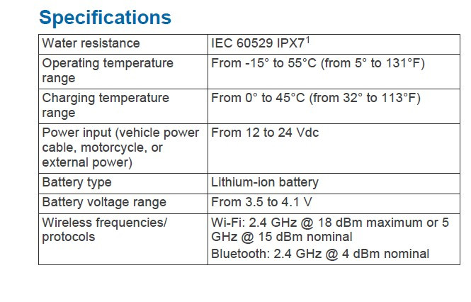

Last weekend we drove home from Germany to Holland with temperatures reaching 33 degrees Celcius (91 Degrees Fahrenheit according to the online converter) I have an XT, my companion a 660. His screen 'went black' a few times, maybe because of overheating, I did not have any problems with the XT.
Edit: It was a 450+ km (280 Miles) trip. Nearly 8 hours driving.
If you look at the manual page 19, your temperature should be well within its range.
