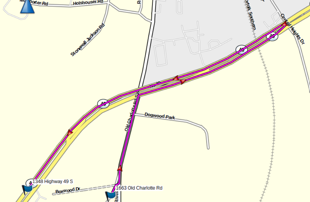

rbentnail wrote: Sun Apr 30, 2023 4:52 pm Coming to a stop sign, in order to go left I have to go right and in about 500 yds make a uturn to go the direction I want to. It's becoming more and more imperative to have prompted recalculation and always either say NO or just ignore it.

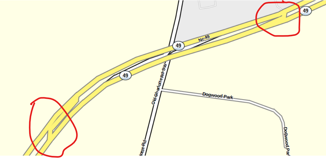

Indeed! This is so frustrating. These u-turns are by design, sometimes having a traffic signal that stops oncoming traffic so that u-turners can make the turn. Most are not on the map (at least not yet) which results in an off-route condition. In the example below, if I am heading north on Old Charlotte Rd SW and want to go west on Rte 49 I must turn east and then make a u-turn, (there is a barricade down the center of Rte 49). This is an intersection that is visible on the map and known for no through traffic on Old Charlotte Rd SW so BaseCamp routes accordingly, sort of. The designed u-turn spots are not recognized for what they are. In this case, making the designed u-turn keeps you on the route. Not so when this forced u-turn design is not on the map and the route attempts to take you through the intersection.

Apologies if I'm being thick about this, but I don't fully follow your example. I can see that in order to go west on 49 you have to get on 49 east and then do a u-turn. What is unclear (my fault, not yours) is what the problem is for the XT. In your example it obviously worked correctly, but you say that in other cases it would not. If the Old C/49 was one of those cases, does that mean the GPS would tell you to turn left at the intersection of Old C and 49, even though it is not physically possible to do so? If my guess is correct, does that trigger RUT? And why would having u-turns disabled make this all worse?

danham wrote: Sun Apr 30, 2023 7:41 pm If the Old C/49 was one of those cases, does that mean the GPS would tell you to turn left at the intersection of Old C and 49, even though it is not physically possible to do so? If my guess is correct, does that trigger RUT? And why would having u-turns disabled make this all worse?
Yes, the GPS would tell you to turn left, or go straight if that is your route. The right turn puts you in an off-route situation. If a recalc occurs, you potentially have a messed up rest of the route, likely exacerbated if u-turns are disabled. If you don't allow a recalc and just do a u-turn to get back on the route then all is well. It would not trigger the RUT issue. AFAIK, the RUT issue is only associated with skipping a point.
It is becoming surprisingly common in NC for major roads and state highways to not have any cross intersections for many miles. Instead they have periodic u-turn spots. These are not limited access roads; entrances from side streets and business parking lots are right-turn only. If you want to go left you may have to drive a couple of miles before reaching a u-turn opportunity. I would be interesting to see what a route might look in some of these areas if u-turns were disabled.
