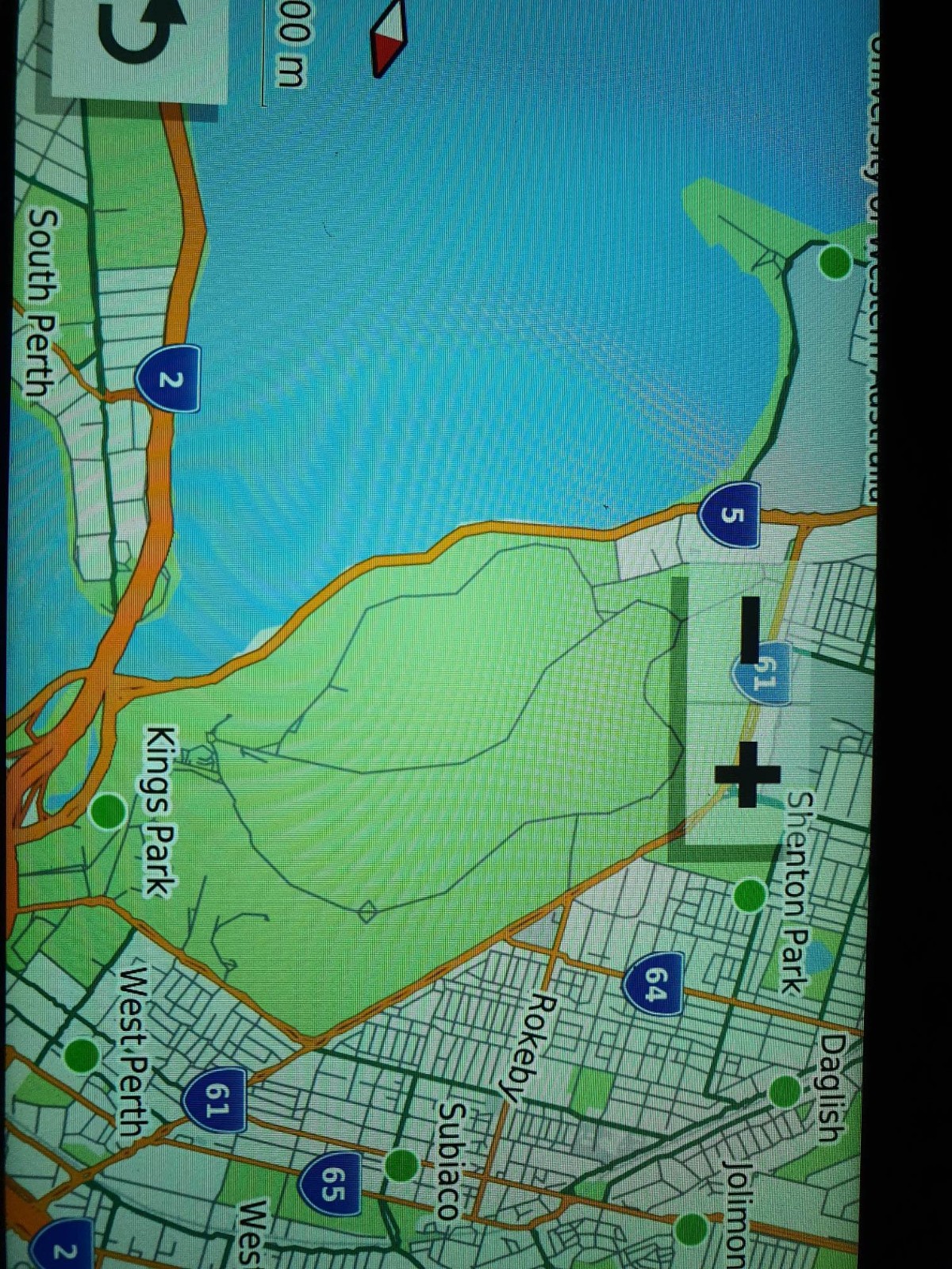

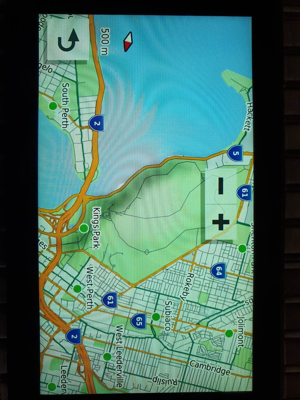

Problem solved. The dark patches are indicating elevated terrain such as mountains, hills etc. Took 3D Terrain off in the settings and they've now disappeared. You can see in the attached photos the dark outline next to the river is an escarpment in the first picture and nothing in the second once that feature is removed. A learning curve it seems, glad I've solved the problem.
3D Terrain.jpg (512.23 KiB) Viewed 1020 times
No 3D Terrain.jpg (671.53 KiB) Viewed 1020 times
