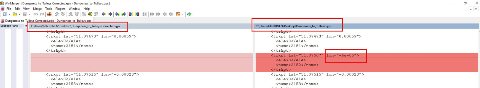

SilverCycle wrote: Thu Feb 23, 2023 9:44 pm One of the failed route files is attached. Irritatingly, this was the return leg, the slightly different outbound trip transferred fine.
I have checked the attached GPX for correctness. It fails to load in Basecamp/Mapsource because it has a LAT value specified in scientific notation. this is the line in error.
<trkpt lat="51.07507" lon="-6e-05">
If I remove that <trkpt> from the GPX it loads in Basecamp, and maybe in your device.
I have attached the corrected GPX.
What to do next? I would say the KML2GPX is causing the error. Maybe you can report the error to them?
alternatively you can try another tool. I suggest you try JaVaWa RtwTool. https://www.javawa.nl/rtwtool_en.html
@SilverCycle If you post your KML file also, I will have a look. Maybe the error is already present in the Google KML file.
Dungeness_to_Tulleys Corrected.gpx
(272.32 KiB) Downloaded 953 times

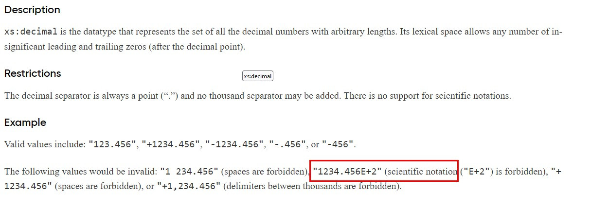

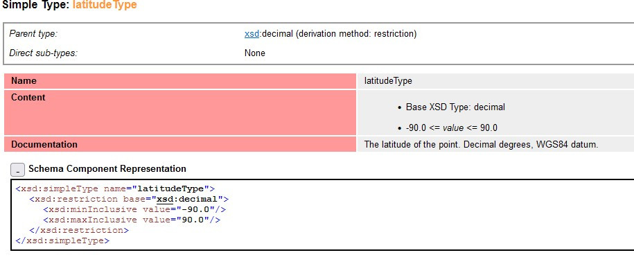

SilverCycle wrote: Sat Feb 25, 2023 9:47 pm I guess I can manually edit that e notation value to zero. As we are Sussex, many routes will transition longitude zero. I guess Garmin’s test cases don’t include long or lat near zero. Is there a published standard for GPX? However, for family use, systems with such stages aren’t any use.
I dont know if Garmin includes test cases near zero for long or lat. But I do know that it's incorrect to specify a Latitude in scientific notation.
Latitude is specified as xsd:decimal. See:
https://www.topografix.com/GPX/1/1/#type_latitudeType
And decimals are specified as:
https://www.oreilly.com/library/view/xm ... /re62.html
Decimal type.jpg (99.63 KiB) Viewed 6335 times
Meanwhile I did a little test with a manually edited KML file. I deliberately changed a few Lat values to scientific notation. The JaVaWa RTWtool mentioned earlier correctly outputs them in a GPX. That is not in scientific notation. So, should KML2GPX not be willing to change, JaVaWa RTWtool is a working alternative.
(And no, I'm not affiliated in anyway with, just a happy user of, JaVaWa)

Yes, I found some stuff similarly, the GPX standard doesn't support scientific notation, on the reasonable grounds that ordinary decimals number range to six or whatever digits work perfectly well for all earth-bound navigational purposes. I also found a number of other GPX-input-accepting programs having to deal with Google's non-compliant output, which apparently, also affects elevation. Thus Google routes very very close to sea level are also sometimes rejected.

The scientific notation will typically sacrifice precision in order to extend its range of numbers that can be represented within a fixed number of digits.
Range is not important for lat/lon - the biggest number required is only 180 - but the precision is essential. Typically if you want precision, you wouldn't use scientific notation. That only gives accuracy to n significant figures. Satnavs need accuracy to at at least 6dp. (0.11 metre at the equator). It doesn't need that degree of accuracy, but it needs to retain that degree of accuracy after it has been through the complex caclulations that the satnav has to perform. Typically, in order to retain that degree of precision, a greater degree of precision is required during calcluation. It makes sense to have the price value stored in the first place. This is because multiplying or dividing very large and very small numbers can produce 'interesting' results.
