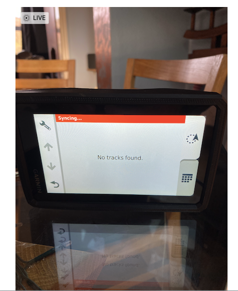

check apps>tracks all the tracks have disappeared but the routes are still in apps>trip planner. screen shot below
![Image]()

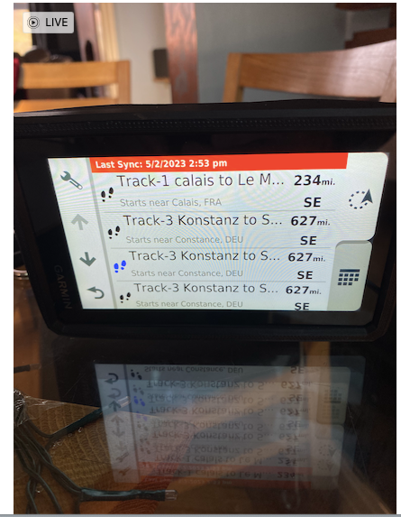

I then enable bluetooth and wifi on my iPad and sit and watch the tracks screen on my XT after 30-45 seconds it starts to sync without any intervention from me.
![Image]()

struggling with the images
![Image]()
- Screenshot 2023-02-05 at 14.54.44.png (418.37 KiB) Viewed 3036 times
- Screenshot 2023-02-05 at 14.54.14.png (381.94 KiB) Viewed 3036 times
