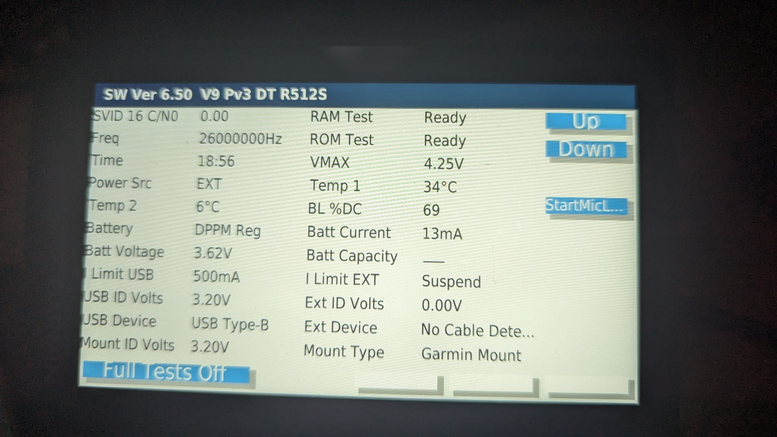

Sometimes mine doesn't show fully charged but it is!
Press and hold the battery icon for around 5 - 10 seconds and a screen will open with a lot of info on and when plugged in it will tell you if its charged or charging

I have a new Zumo XT with SW ver. 6.50. I have it charging off a wall plug and these are the numbers I am getting. The Batt Current is peaking at ~ 38mA. Does this seem right? I am concerned as it appears to be losing charge sitting on the desk. I am pretty sure it was turned off, but I will check when it is charged.

Aushiker wrote: Thu Feb 02, 2023 11:02 am I have a new Zumo XT with SW ver. 6.50. I have it charging off a wall plug and these are the numbers I am getting. The Batt Current is peaking at ~ 38mA. Does this seem right? I am concerned as it appears to be losing charge sitting on the desk. I am pretty sure it was turned off, but I will check when it is charged.
I don't know what the battery current should be, but when you're switching it off, are you doing it by pressing down the power button on the back and when the prompt shows, selecting "off"?

An update:
I charged the unit over night and this morning it was showing 90% battery capacity. I turned off the unit via the proper procedure, left the unit off for two hours and then turned it back on and the Battery Capacity is now showing 88%.
Would this be considered normal?
