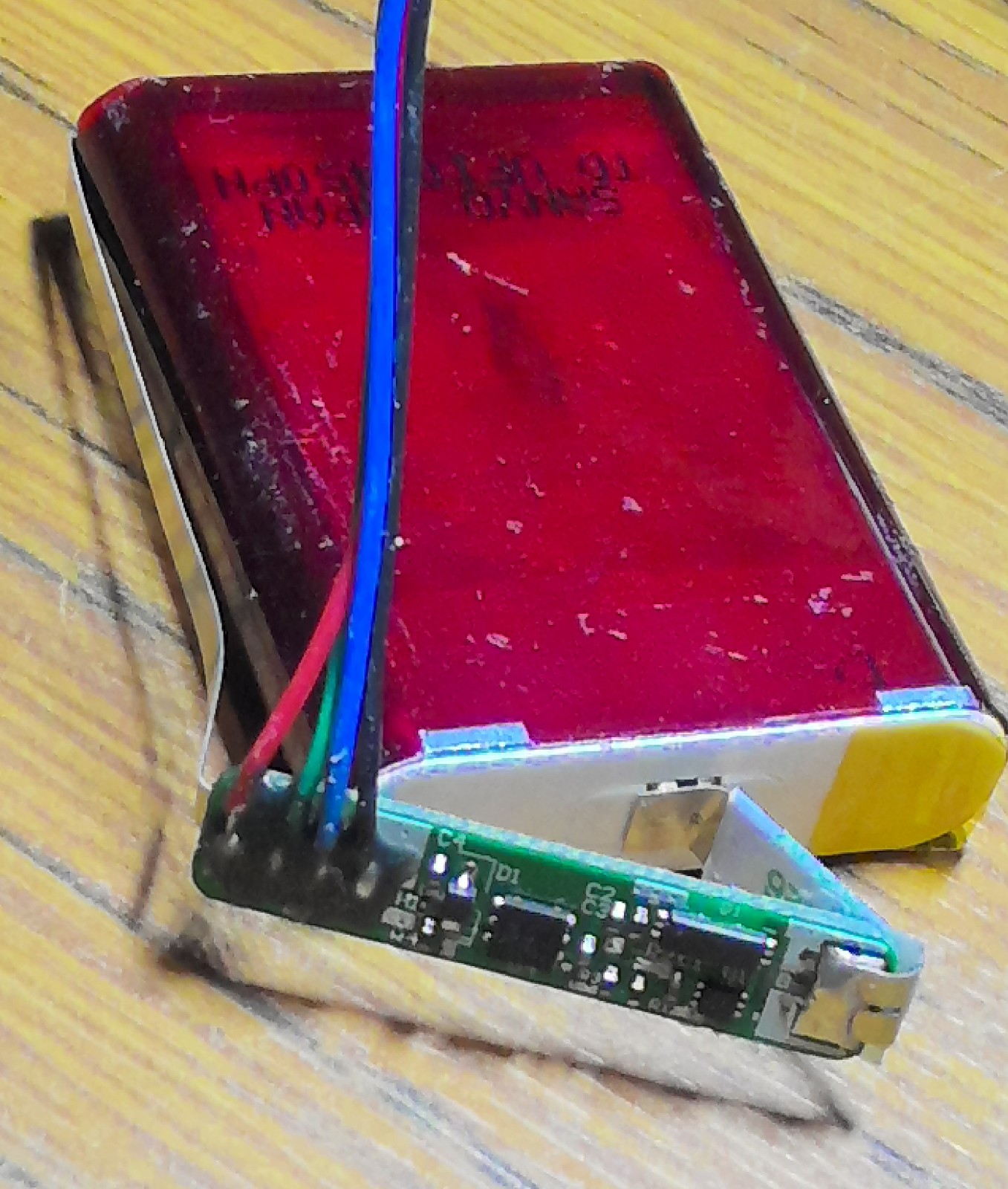

Re: Zumo 590 & 595 Battery life & charge problems
Hopefully I've managed to attach a photo here of my disassembled 595 battery:
There is a CMU (Charge Management Unit) underneath all that wrapping.
