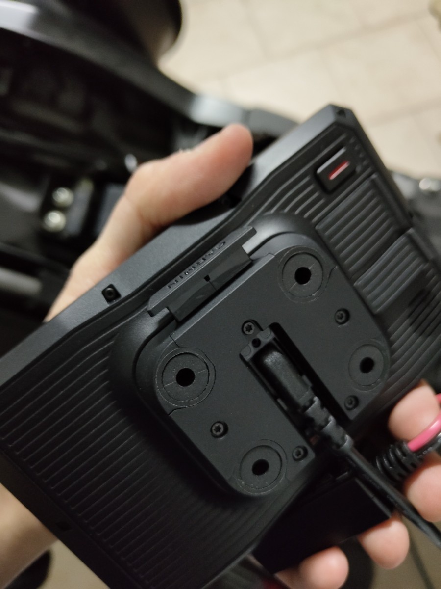

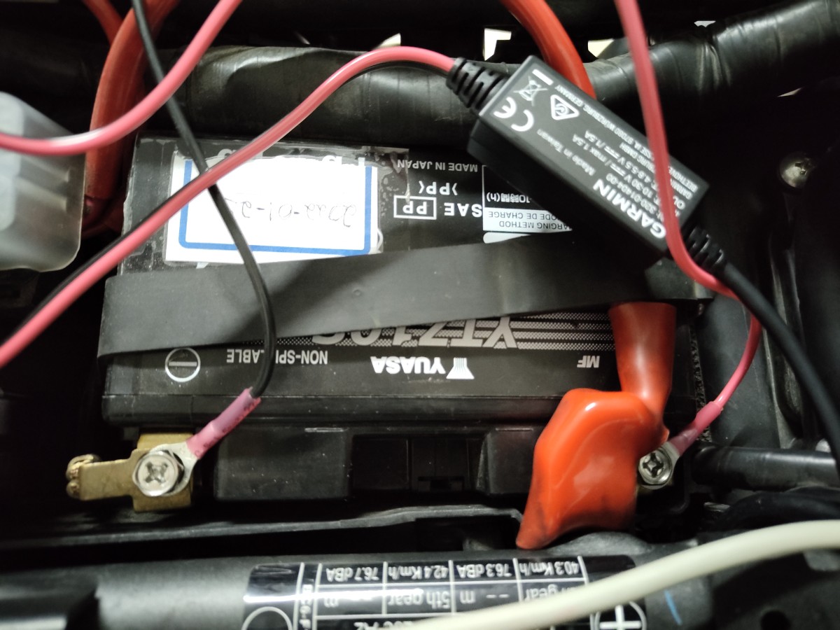

Hello guys,

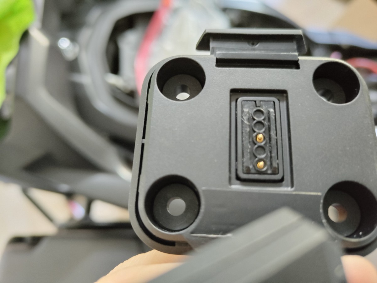

Just installed my Zumo XT. Used the heatshrink hooks and connected directly to the motorcycle's battery (which is in great condition).
Now when I attach the GPS unit to the cradle it won't charge.
Am I missing something? Or is this a case of bad wiring?

Mount the cradle and see if that helps. The top of the cord, where it inserts into the cradle, is held in place by the mounting of the cradle. In fact, some of us have had to put a piece of foam weather stripping on the back of that cord before mounting the cradle so as to add just a touch more pressure which then forces the pins out the other side a bit more, increasing contact with the back of the XT.
There is a photo here: viewtopic.php?t=1770&hilit=foam&start=20. I believe much of that discussion is relevant.

The block with the pins that fits into the rectangular hole. Doesn't that need to be secured with a small screw to stop the XT pushing it out.

As others have said, you do not seem to have secured the cable into the mount base with the tiny screw. The cable is probably moving around.
https://www8.garmin.com/manuals/webhelp ... BE12E.html

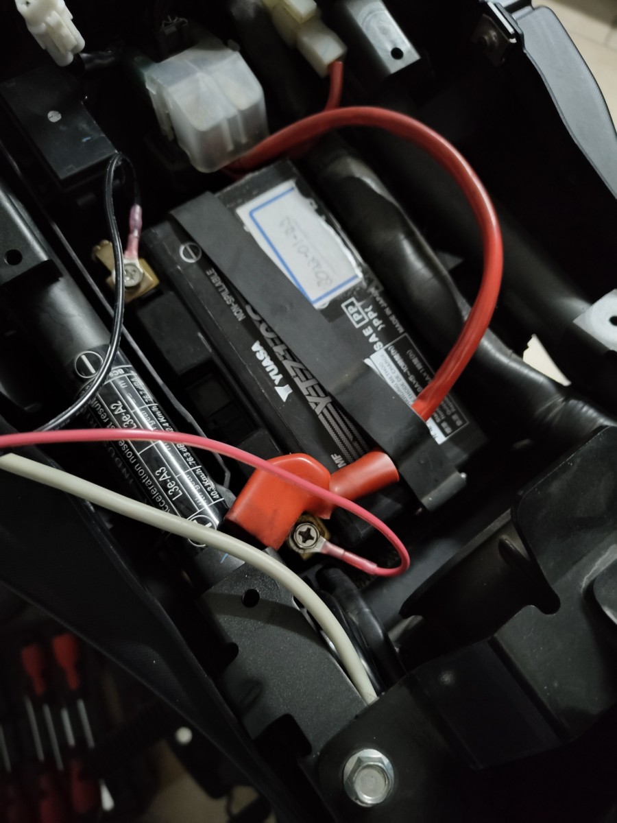

I would check the connection pins with a multimeter to see if there is power to the pins. If not do you have the fuse inplace and if so the fuse good? Lastly check you connection points, splices, etc.

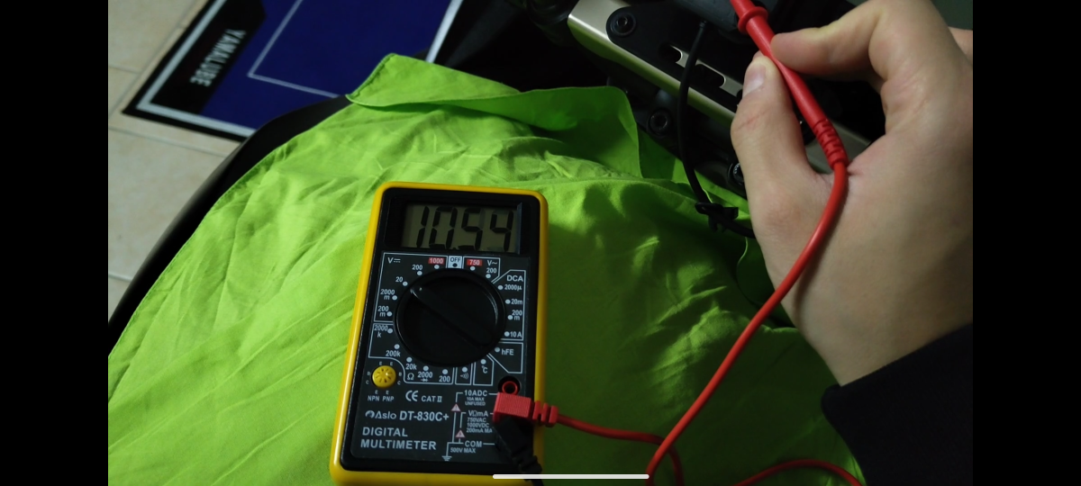

Got a new power cable from Garmin. The pins on this one seem ok. Mounted the cradle and still no charging.
I should have a 5volt read on my multimeter if I check the pins right?

Yes you should be seeing around 5v on the pinsthesexpistol wrote: Wed Nov 09, 2022 10:54 pm

I'm actually getting 10v at the pins

If you are getting 10 volts at the pins the cable is faulty. The little black box steps the 12 volt supply down to 5 volts for the XT.
Just noticed! the red lead on your multimeter is in the wrong hole! it should be on 'DC' not AC. Move it & retry.
