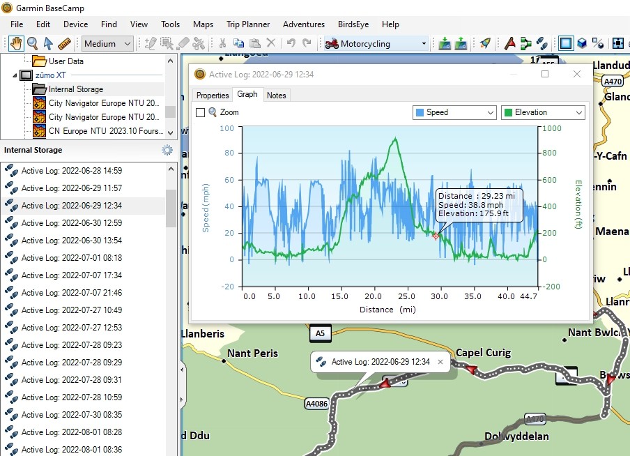

But BaseCamp has a lot more tools that many people know about, and it can be pretty good for keeping tracks and routes organised.
Any route, any track and any collection of saved locations (waypoints) and Points of Interest can be loaded into it and investigated.
Did you know:
  • That if you have a lot of track fragments, then Basecamp will join them together for you in one simple operation ?
  • That it will give you detailed information about every single point that has been logged in an Active_log track or in a manually recorded track ?
  • That this can be presented in Graphical Form as speed vs Time / Elevation vs Time or speed & elevation superimposed on the same graph.
  • That you can trace through the graph with your mouse and see the location plotted on the map as a moving figure
  • That you can zoom in to a recorded track to inspect a portion of the track in more detail.
  • That you can import other recorded tracks - not just the Active Logs that are visible in BC by default.
  • That you can export your route or tracks as KML files which you can then 'fly' in Google Earth ?
  • That you can use the list folders and lists to organise your tracks eg by Year, by location. Basecamp uses a relational database type structure in that if you want an entry to appear in a number of folders at once, you can do that. The second, third, fourth entries simply place a pointer to the original.
Here's an example of a Basecamp snapshot that I created the other day. Click the image to see a larger copy.
P999 - Tracks Pic 1.jpg (156.12 KiB) Viewed 1553 times
