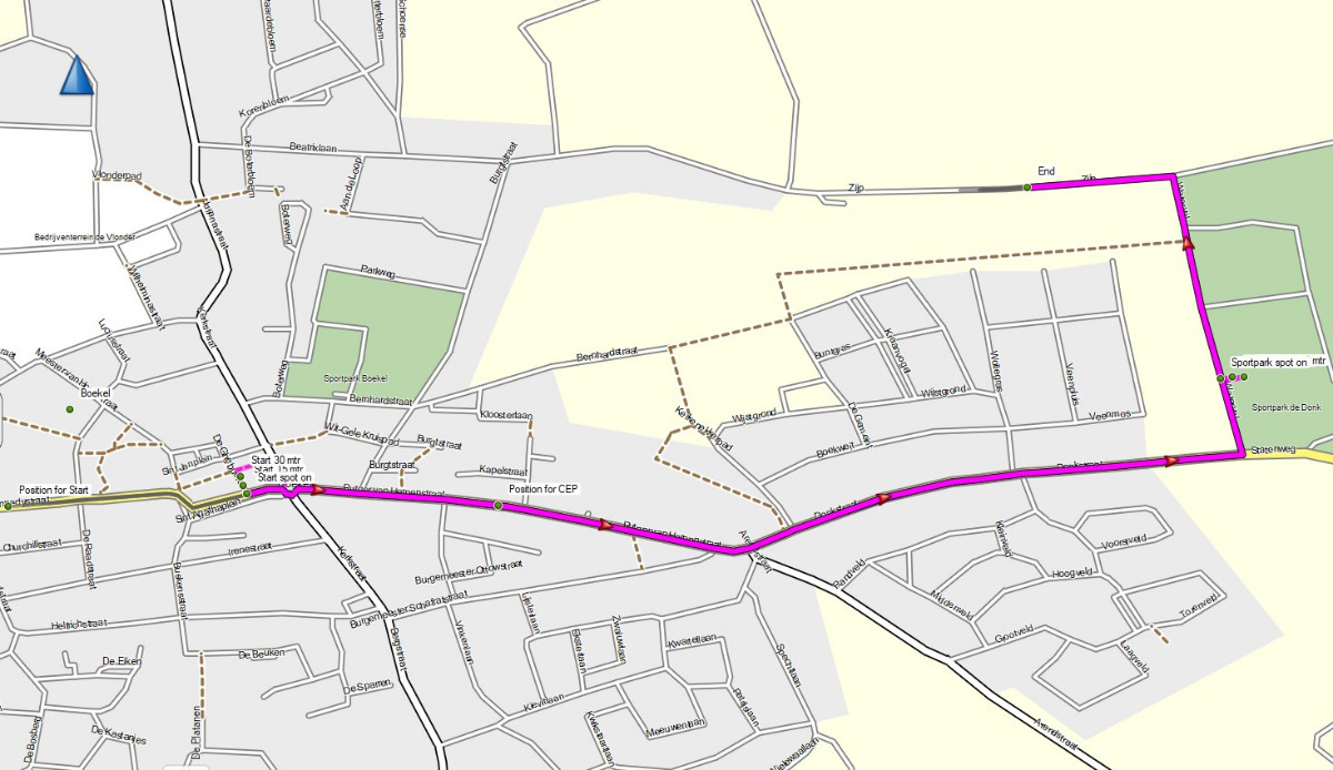

This morning I did some testing. My conclusion, based on these basic tests, is that the margin is at least 30 meters. That is
approximately 100 feet.
I did not encounter any problem, so to find out when it goes wrong I should repeat these test with a greater margin. But for now i'm happy with the results.
Does anybody know the margin for 'hitting' a Via point?

- RouteOverview.jpg (178.03 KiB) Viewed 1513 times
- Test results.docx
- (447.21 KiB) Downloaded 393 times
