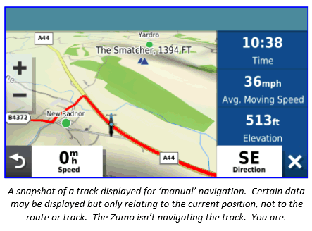

This method is as simple as a satnav gets. In effect you are looking at a paper map with a hi-lighter line drawn onto the roads you intend to take.
The satnav marks your position with your chosen vehicle, and scrolls the map to ensure that your vehicle is shown centred if the map is drawn with North at the top, or towards the bottom centre if the map is drawn in 3D or in ‘Track Up’ mode.
The track can be one of a number of colour options, and can be set to one of 3 widths. If the feature is enabled, a blue track is superimposed onto the map showing where you have been.
