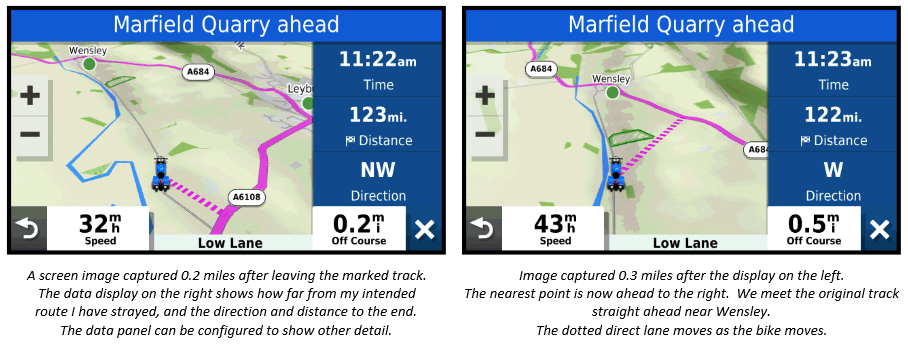

The two Zumo XT screen images below are captured 1-2 minutes apart, and show the intended track as a solid magenta line .
The two screen images below show the XT screen after I have deviated from the track. The captions tell the story.
If you start to navigate a track and haven’t yet reached the start, the XT will show the dirction and distance tot he start as a dotted straight line in a similar way to these two screen shots.
