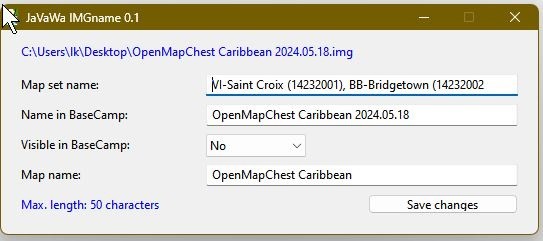

As an a example, I downloaded an OSM map for the Caribbean (because it was fairly small) and installed it in Basecamp, then used MapInstall to load it on my XT. I copied it back to my PC Desktop for editing in JaVaWa IMGname (for more or larger maps, just move the SDcard to the PC.)
The blue top line shows the file name on my desktop and the SDcard.
"Map set name" is the useless name MapInstall made up from locations on the map and which is displayed in MyMaps on the XT. That's the name you want to change, then Save changes.
