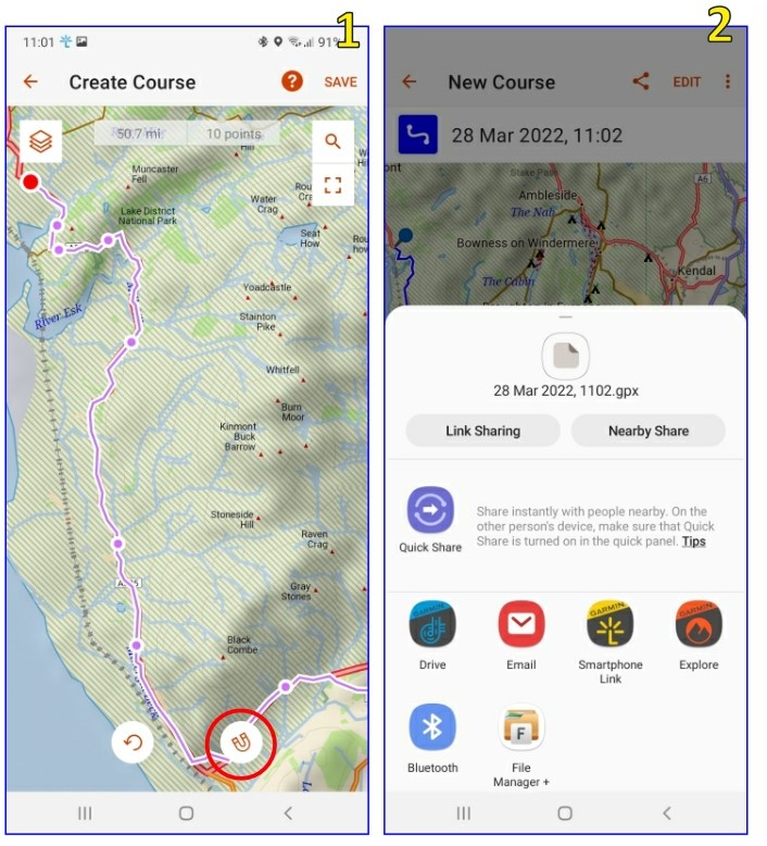

Pic 1 - The Course Editing screen.
The Magnet icon toggles the creation of courses that stick to roads and paths with courses that are straight lines between adjacent points. Points can be moved and deleted. Selected section can be dragged to follow different roads and paths. The undo button is really useful. Once saved (top right), other options become available.
Pic 2 - Sharing the Saved Course

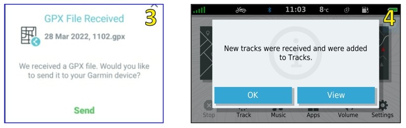

Available after the route is saved. The file gpx file is named with date and type and can be sent to any apps that have the facility. In my case the app is on the same device as my Drive App, so I selected that. The Drive App opened and sent it to the XT.
Pic 3 - Drive App Message
The gpx file shared from the Explore App, pops up a message on the smartphone, prompting you to send it to the XT.
Pic 4 - Message on the XT
If the XT is turned on this message pops up immediately. If it is turned off, it pops up as soon as the XT is turned on.

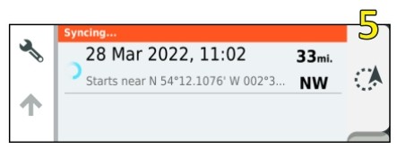

Pic 5 - Where To ? -> Explore -> Tracks
Here the XT is still synching with the Explore database, but it has found the Course that I created. There is no special category for 'courses' on the XT: They are treated as tracks - which means that you will not get turn by turn instructions - unless you convert the track into a Trip.

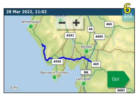

Pic 6 - The Preview Map
The preview map - shown here on the XT screen reproduces the track (or course) exactly as it was plotted in the Explore App. Pic 6 shows the entire track, Pic 1 shows the Explore App detailing just the most westerly part of the track - nearest to the coast.
There are no route points associated with the track - although if you created Waypoints in the Explore App, and added those to the same collection as the course, then the Waypoint symbol will show on the map. But that is all. For example, there are no alerts as you approach as there would be for a Via Point in a route. If you do not visit one the satnav doesn't care. They are not a part of the route - they are just shown on the map for interest.
