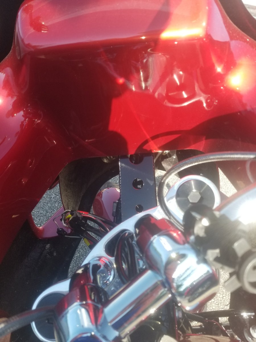

Good points on the vibration of the fairing. I had not considered that. I checked by feeling the fairing with cruise control on while going down the interstate. It wasn't too bad, but enough to make me consider alternatives.
The fairing mounts to a steel frame on the front of the bike. There are less vibrations on this frame. This may make a good mount point. (Black frame in middle of image below )

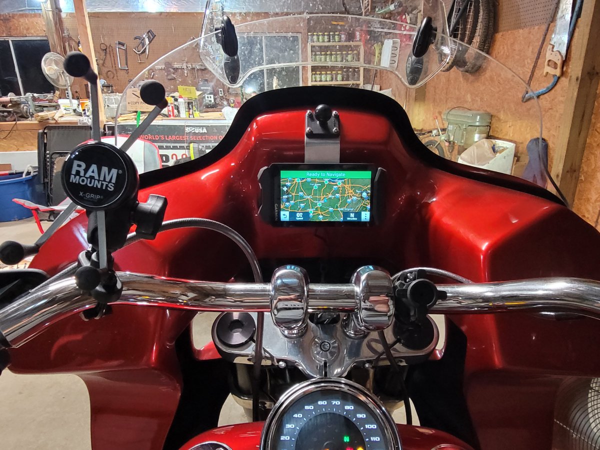

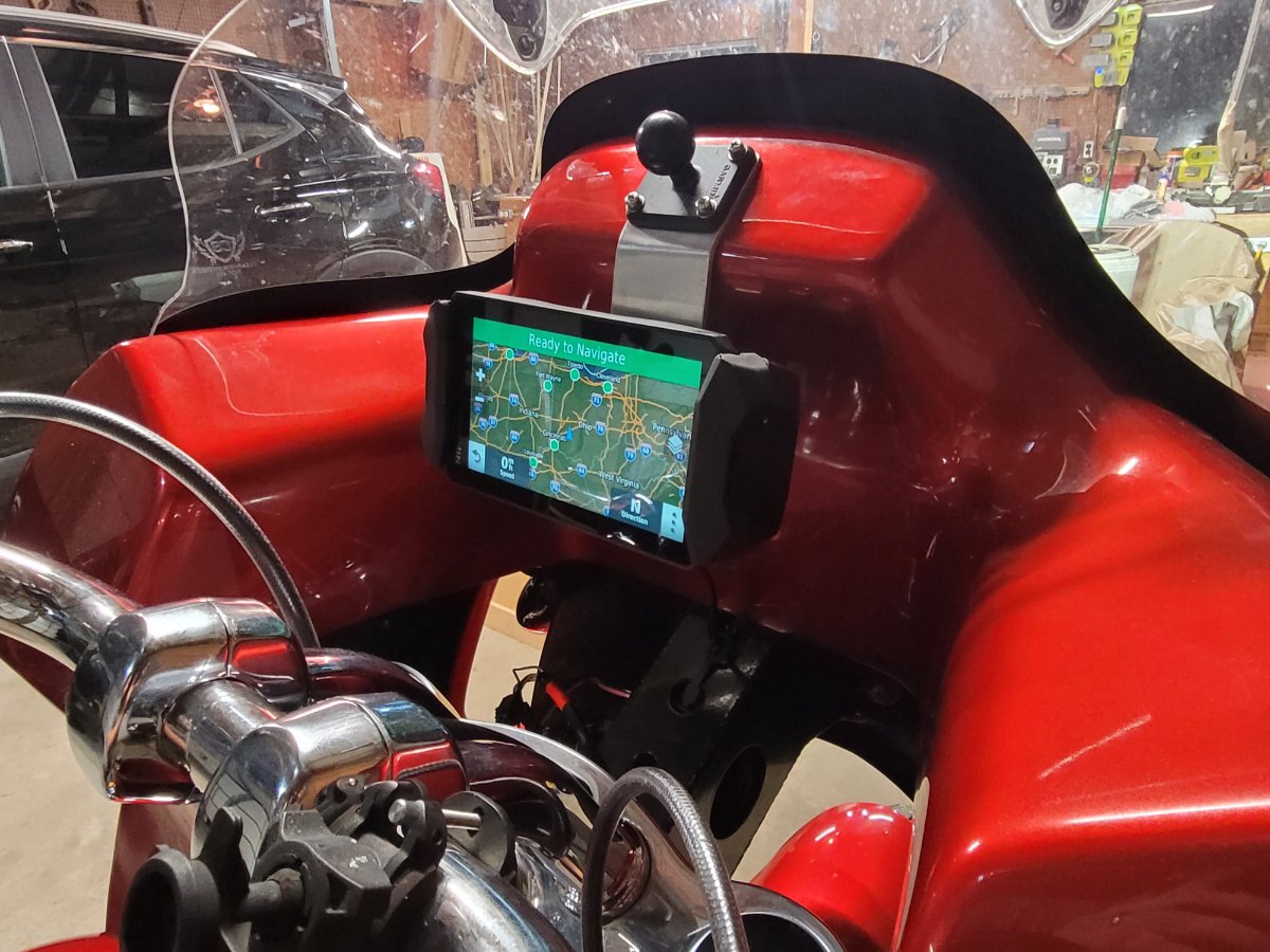

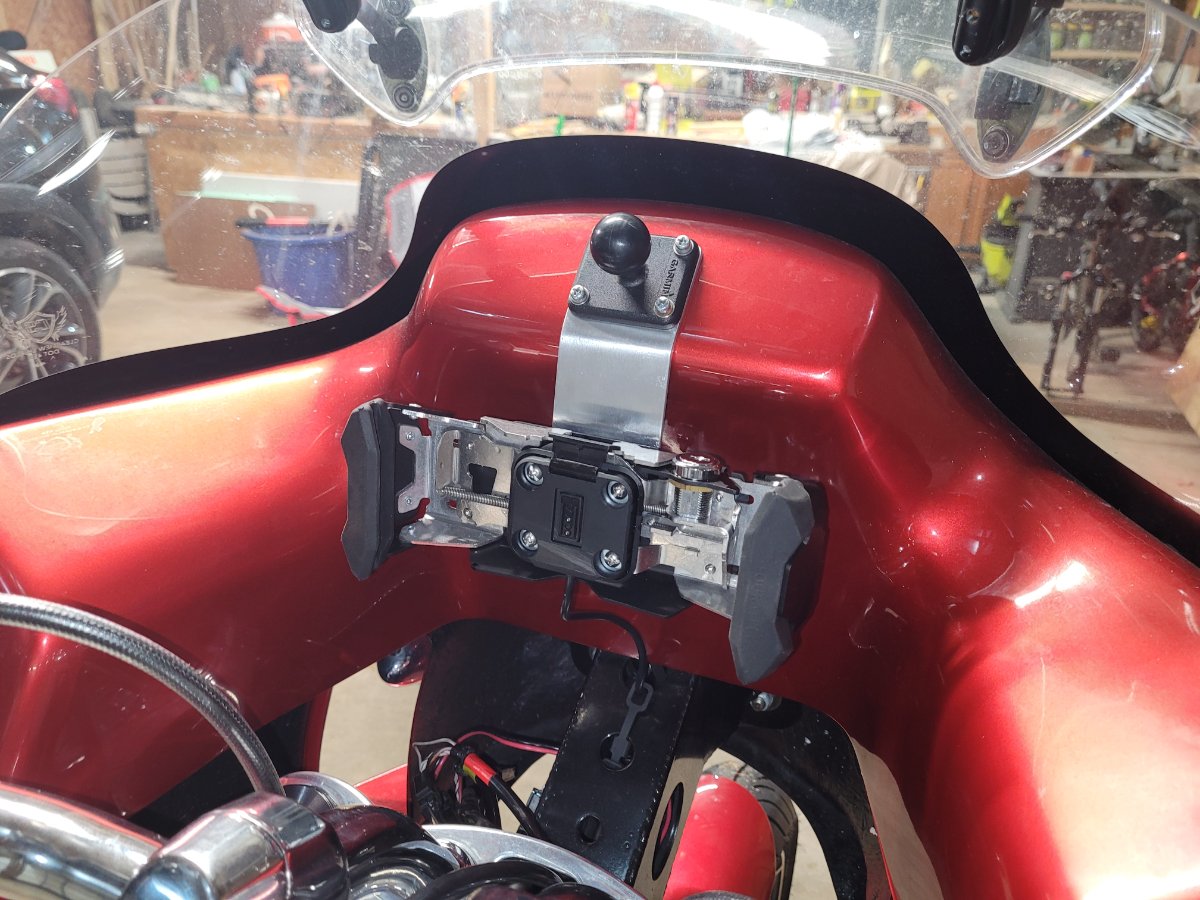

My plans to fabricate a nice mount fell through as work schedules flood my time. I ended up making a quick-'n-dirty aluminum bracket from bent 2"x1/8" flatstock. I put a RAM ball over top part of the bracket just to cover up some of the blan aluminum. A locking mount from Touratech took care of the rest. I few road tests today show that the position, visibility, and legibility are all good.
