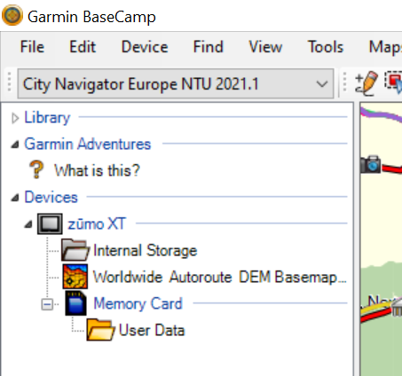

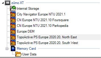

The Zumo/Basecamp is reporting to me that the maps are different when I post over routes. And yet they both maps have the same number. Also I have an increasingly bewildering tally of maps on the Zumo now and I am not sure what they are?
See attached

From the top they are the road map, POIs, parking places, Digital Elevation Model, and topo maps covering Europe.
I can see the CN map on your Zumo is 2021.1, I suspect on BaseCamp it's 2021.10 hence the issue. If you confirm that I'll explain how to change it.

In my XT it does show it as 2021.10, but Basecamp shows 2021.1 but the Map Product Manager shows it as 2021.10 though I only see the base map when looking at the maps in Basecamp. :?

Skipper wrote: Tue Apr 20, 2021 7:17 pm Sussamb, would appreciate if you explain how to fix this issue with different maps.
This problem occurred once before a few years ago now. The fix then was to rename the map on your device by adding the missing zero. Normally I'd suggest renaming it using JaVaWa's Device Manager but other posts on this forum suggest it doesn't see the XT version. So instead use JaVaWa's GMTK program to rename the map on your PC and remove the final zero

Well I can beat the "maps not recognised so recalculated the route" by sending the routes to the micro SD card I have in my XT, and then importing them into the Trip Planner :D And then the routes look like the Basecamp ones, with similar distances and timing.
