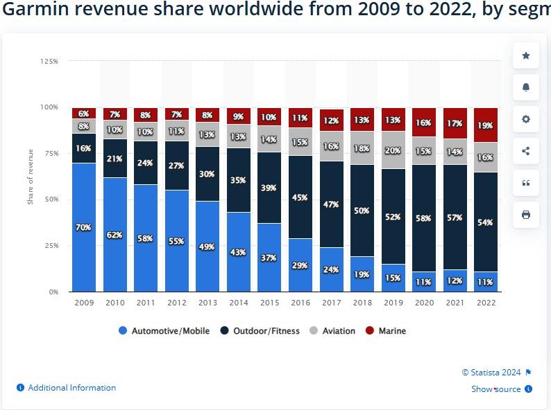

I think this is the reason that Garmin doesn't gove two hoots about Motorcycle Sat Nav's any more.
The automotive mobile element of their business is most likely dominated by OEM equipment for vehicle manufacturers motorcycle navigation units I expect are a very small (if highly profitable) market. The instrument/Android Auto cluster on my 2021 Honda Africa Twin is made by Garmin. The XT and XT2 are great bits of hardware but Garmin's software and firmware now leaves a lot to be desired. I two have used Garmin NAVs on my bikes since 2004 and still have my old Garmin 2610, NAV IV 340,390 and an XT. But I think that the way to go now is a second rugged phone and one of the many routing apps. If Garmin completely loses the motorcycle market it only has its self to blame.
I sometimes wonder if all of the good automotive programmers and product testers retired from Garmin or got reassigned about 2015-6??
At least the old Garmin units go on for ever and work well with Garminised open street maps.
Posts: 3067
It doesn't actually reveal much useful info, does it ? The diagram doesn't match the title.

No not really. I was just wondering why Garmin don't appear to be doing well in relation to Motorcycle Sat Navs now. Too many difficulties and workarounds these days.
