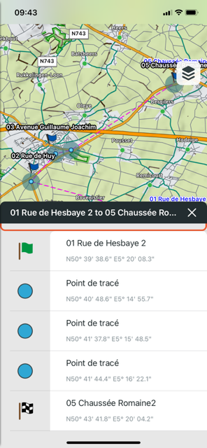

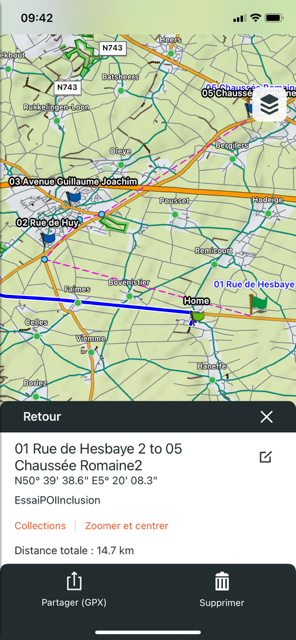

@jfheat: An other finding that could be interesting. After the above testing, I deleted the corresponding route in explore with Tread.Javelin16 wrote: Thu Jan 18, 2024 6:09 pm Just after import on the XT2, perfect results (3 WPs, 3 shaping points at the correct location, good route). After sync in Tread, alteration of the basic data ( 1 WP lost,2 shaping points location changed, 1 lost and consequently, route modified). This sync alters also the data on the XT2 (3 WPs ok, 3 shaping points moved, route modified), all this without using the route in Tread and thus simply from the sync between the XT2 and Tread.
Back to the XT2, two strange things:
1. When I look to the explore option on the XT2, the route, deleted in explore with Tread, is still there. Strange, because when you look to the marketing info on the XT2, it is stated "Easily manage tracks and routes across your navigator and compatible smartphone by using the Tread app". Not easy if the data you access by the option "explore" in Tread or on the XT2 are not the same!
2. More interesting, the route on the XT2 is now back to its shape just after import of the route on the XT2. The shaping points are again identical to the shaping points in Basecamp. So, it seems that the initial correct route data was not erased by the sync with Tread. The link was probably modified to the route in explore, but the initial data (probably in current.gpx? ) is still there. It seems that when the route is deleted in explore with Tread, the link to explore on the XT2 is of course no more effective but the link to the initial route data (in current.gpx?) is restored.
Interesting: this could provide a way around the issue of the modification of the shaping points of the route by explore. After the sync, delete the route in explore and on the XT2, the initial route data are effective again.
I need a carefull check to validate this assumption because maybe I did something else that influenced this finding. But hope is back...

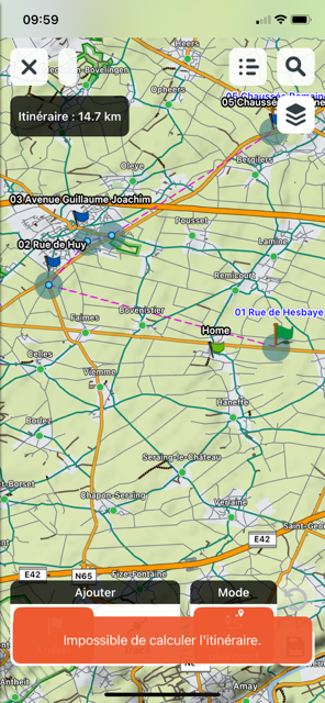

When I go back to the Tread app after the sync with the XT2, the mods from the XT2 sync induced obviously a new sync with explore and the route is now modified in the explore db in Tread. Shaping points as on the XT2, but the route is now just straight lines through the new shaping points on Tread.
The route just after opening in explore with Tread: The corresponding shaping points: When I try to edit the corresponding route in Tread, error message: The mods induced by the sync between the explore db and the XT2 are not very safe either way...
