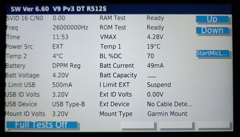

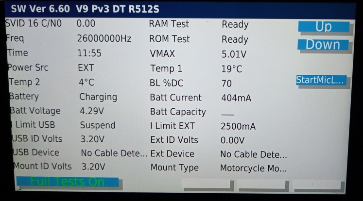

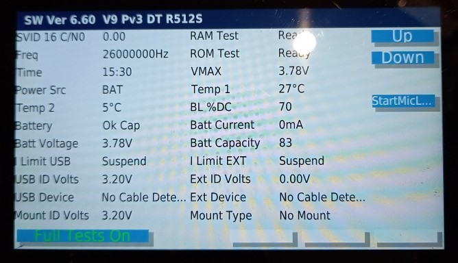

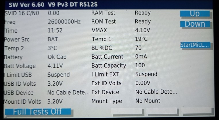

Screen shots of my Zumo XT - Power Status screen
I haven't got much of a clue about what this will tell you, but you might spot a difference.
1. Powered from Internal Battery Fully Charged
1a. Powered from Internal Battery nearly 4 hours later
2. Powered from Wall Socket USB outlet to USB connector
3. Powered from 12v to Harness and M/Bike Cradle
I came back to my desk nearly 4 hours later to find the XT still on, still showing the battery status screen. No external power source.
So I've added that photos as # 1a. It wasn't doing a great deal, but the backlight had been on all the time, and it reports battery level at 85% !!
That was a suprise.
I noticed that the photos are not consistent - Full Tests On vs Full Tests Off. Toggling that apperaed to make no difference to the displayed values.
