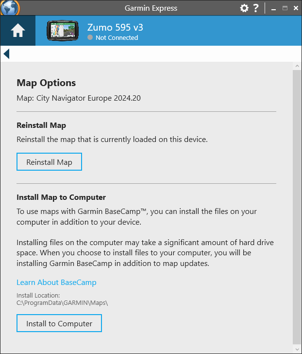

Re: ZUMO XT2 CONCLUSIONS
There should be an option on the Express screen to install the maps to the computer.
From the main screen: Map Details -> Map Options -> Install to Computer
Don't change the default location, otherwise Basecamp may not find the map.
Basecamp isn't involved in this process. Once installed, Basecamp finds the new maps.

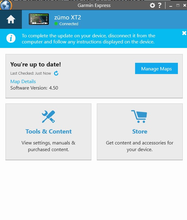

Here is how it works with Express 7.19.0.0 and my XT2 on a Windows 11 PC.
The opening screen of Express shows my devices. I click on the Zumo XT2 button. I get this screen

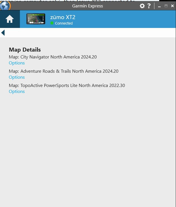

I click on "map details" and I get this screen
Express screen _2.jpg (48.85 KiB) Viewed 2391 times

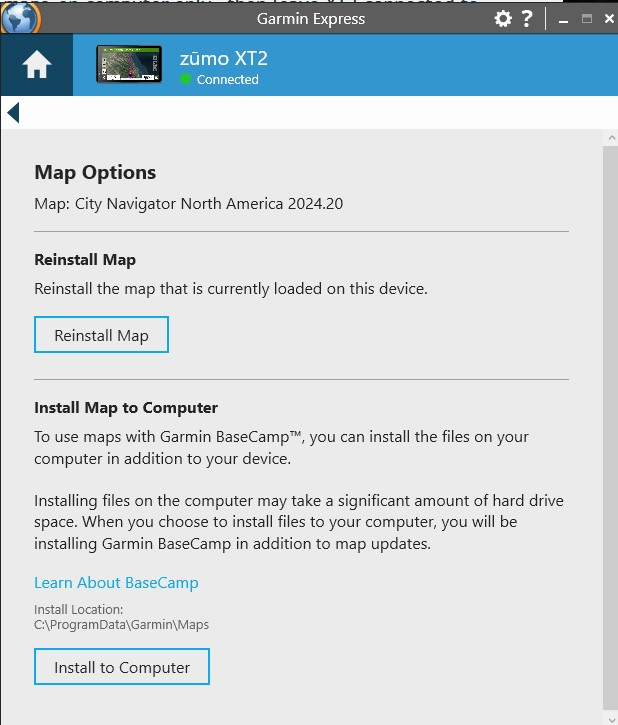

I click on "options" under "City Navigator North America 2024.20" and I get this screen
express screen _3.jpg (81.88 KiB) Viewed 2391 times
I click on Install to computer and it copies the file from XT2 to the default location on my PC.
