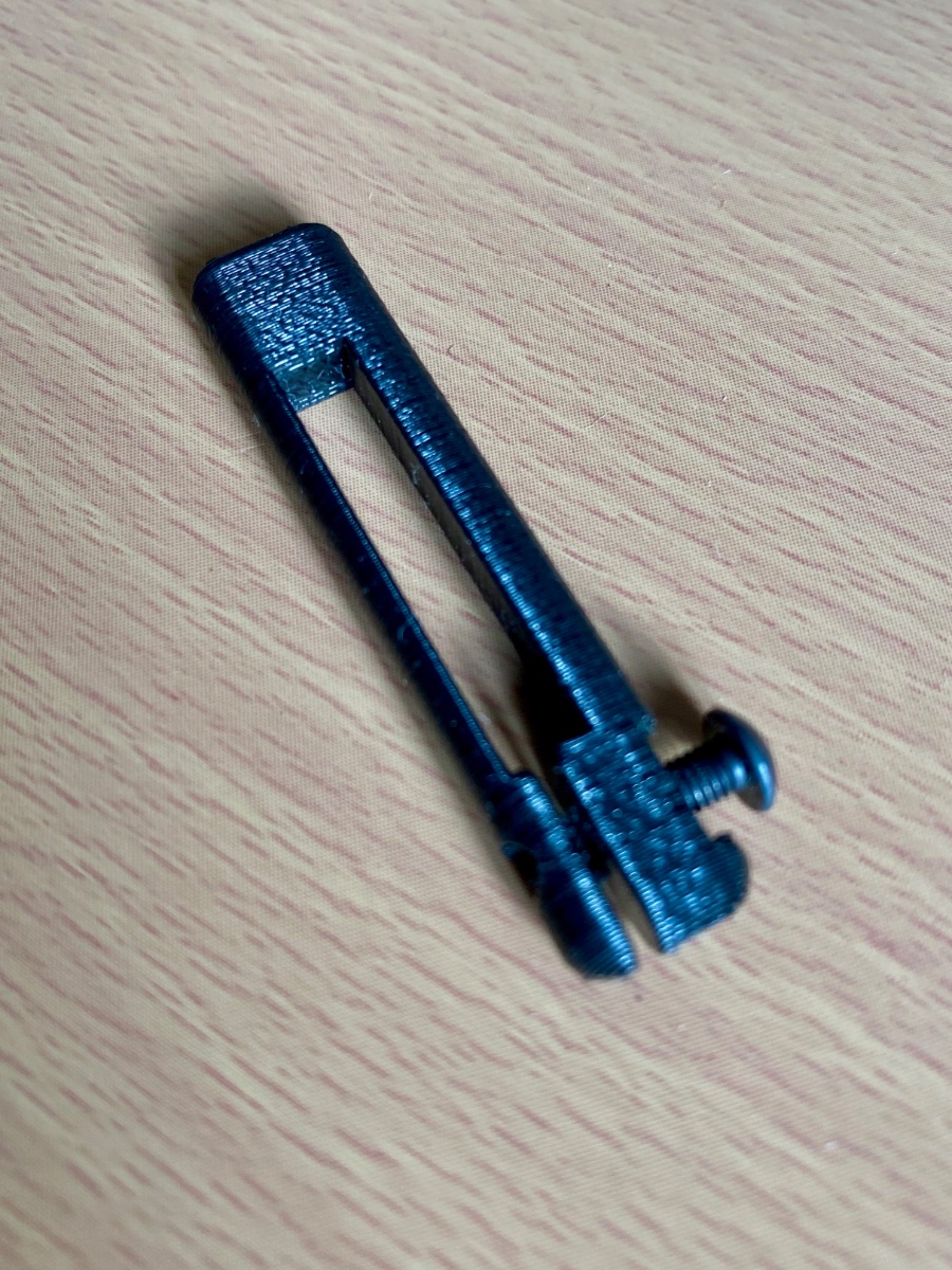

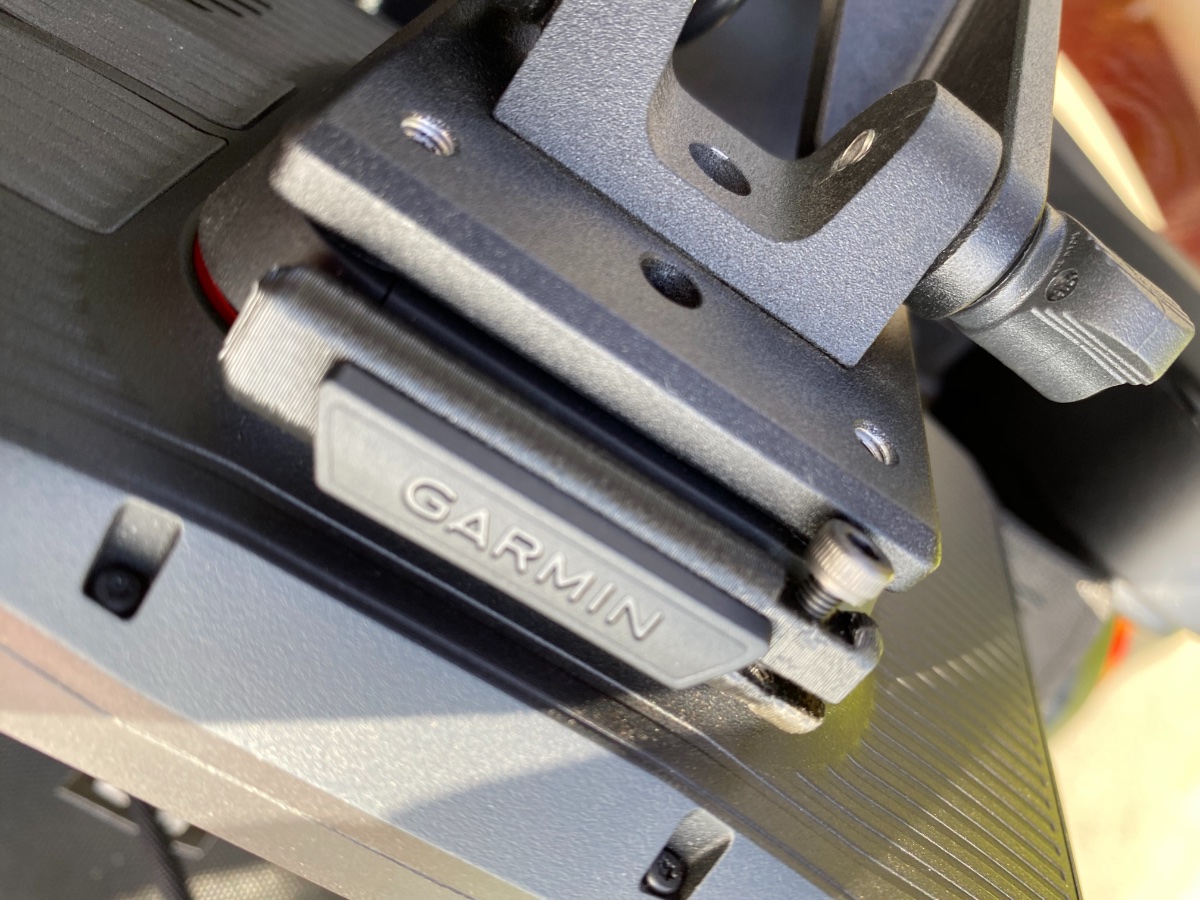

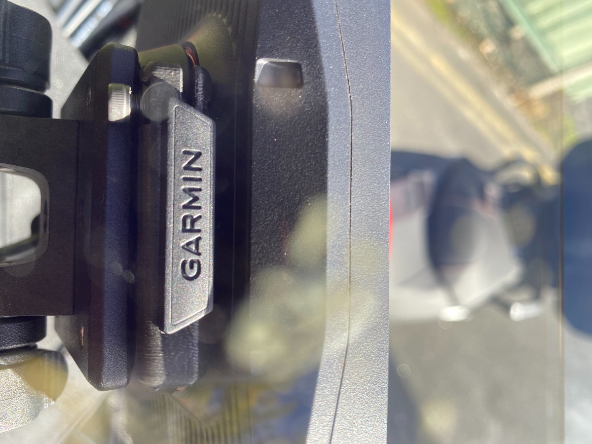

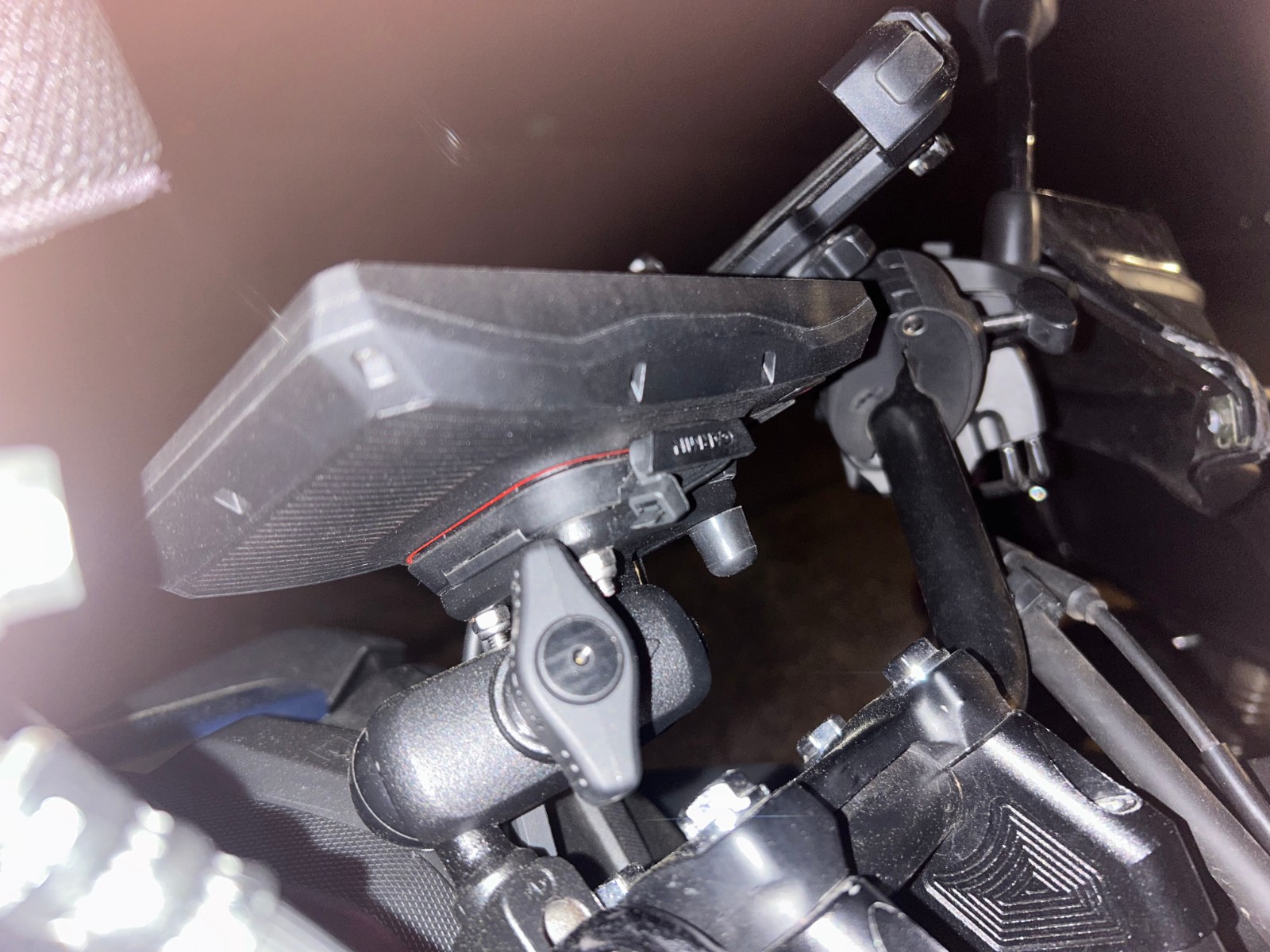

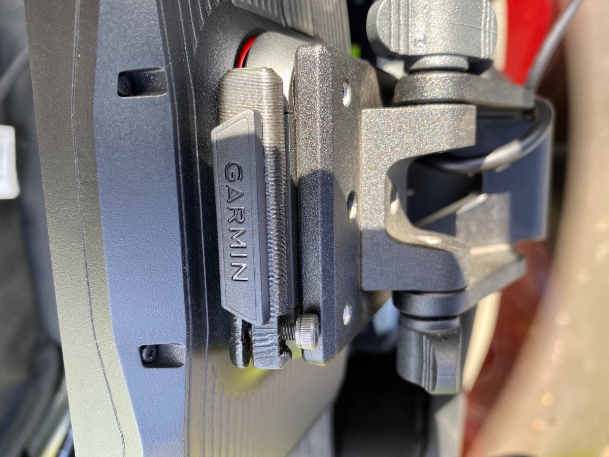

Designed and had 3D Printed a lock clip - printing was PLA (FDM) 75% strength. M3 thumb screw or M3 domed bolt will self thread once screwed in and the release button on the Garmin mount does not move, even when the screw is not fully engaged. Not a perfect fit due the tight gap between the release button and the Zumo; it will also not work with the 3D Printed mount covers out there. Working well for me and just gives a little more piece of mind and security when stopped.
Link to the STL file if people want to edit / use https://www.tinkercad.com/things/kI1bb3MU3g3
On Evotech Perfomance mount with M3 Thumb Screw
With M3 domed bolt
With M3 domed bolt

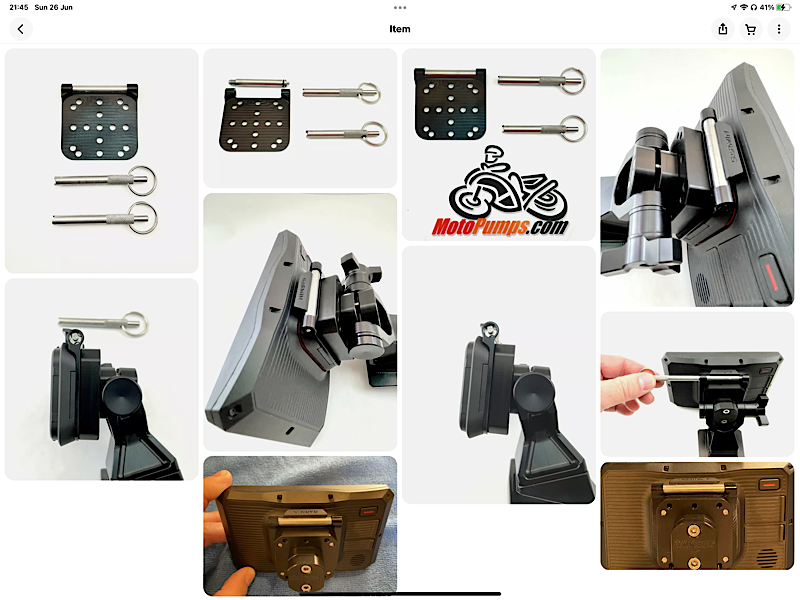

Post by Johnsondvr »
Now installed one of these. Excellent bit of kit.
https://www.ebay.co.uk/itm/29503786920 ... media=COPY
