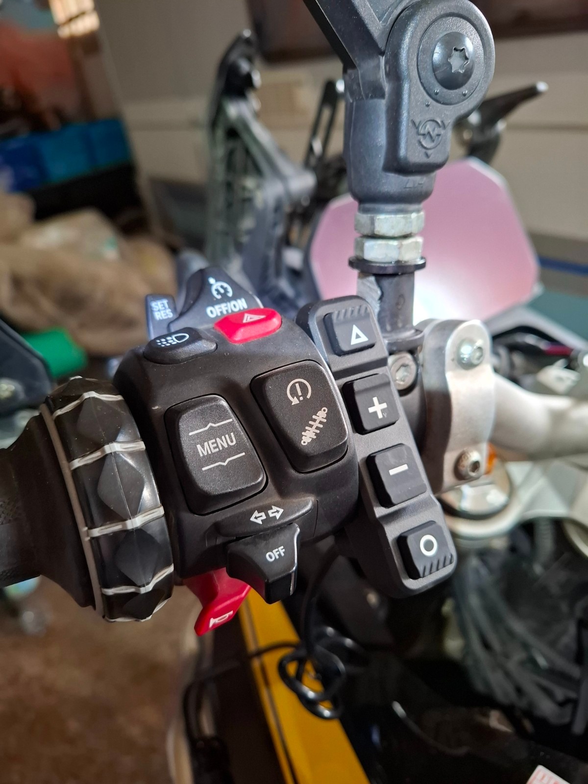

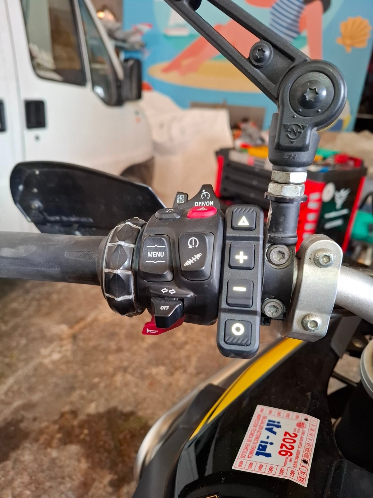

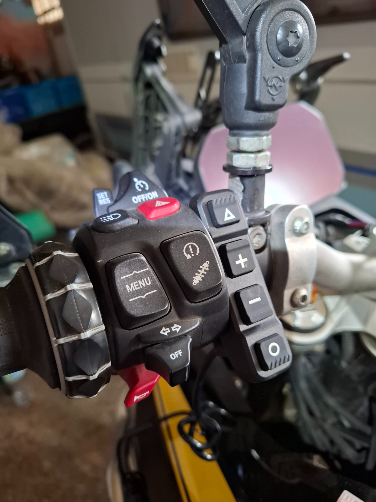

Playing, I have installed everything according to the scheme that was shared on the forum. Trying different options. The feel of the buttons is very good.

Thanks for posting those @turbo19 .
Please excuse me (ab)using my moderator privileges and copying the images to twist them through 90 deg).
It looks like a really good fit on your bars.

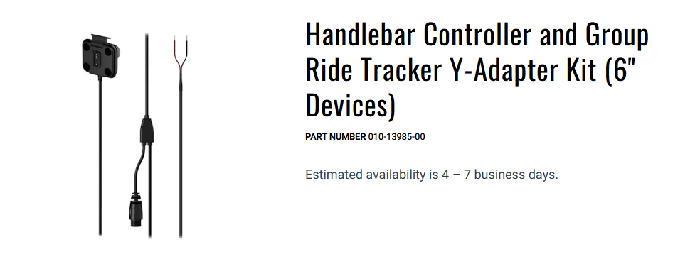

Just answering a question on FB page. Someone had ordered a cable that I didn't recognise.
Santa brought me my handlebar controller and high current cable and the necessary Y adapter. Clever of him to work out what was required.
But looking back at the Garmin page to see which cable this chap had bought - and a new one is now listed on the Garmin site.
This cable was not there when I ordered my setup at the end of November. There is no price showing at present and it is says that it will be available in 4-7 days. (Current date 28 Dec 24).
And it is shown as being compatible with the Handlebar Controller, with the Tread GPS and the XT2 GPS.
And it matches the diagram in the instruction manual. And it has a new mount for the XT2.
That is really irritating. I've modified my post of 9 November to alert anyone else that it is not necessary to buy two expensive cables when one expensive cable is all that is needed. I've included the same image in that post as well.

I have the same problem. I have ordered the return of the other 2 cables (accepted by Garmin), and I am waiting for the price of this new reference. Disastrous marketing.

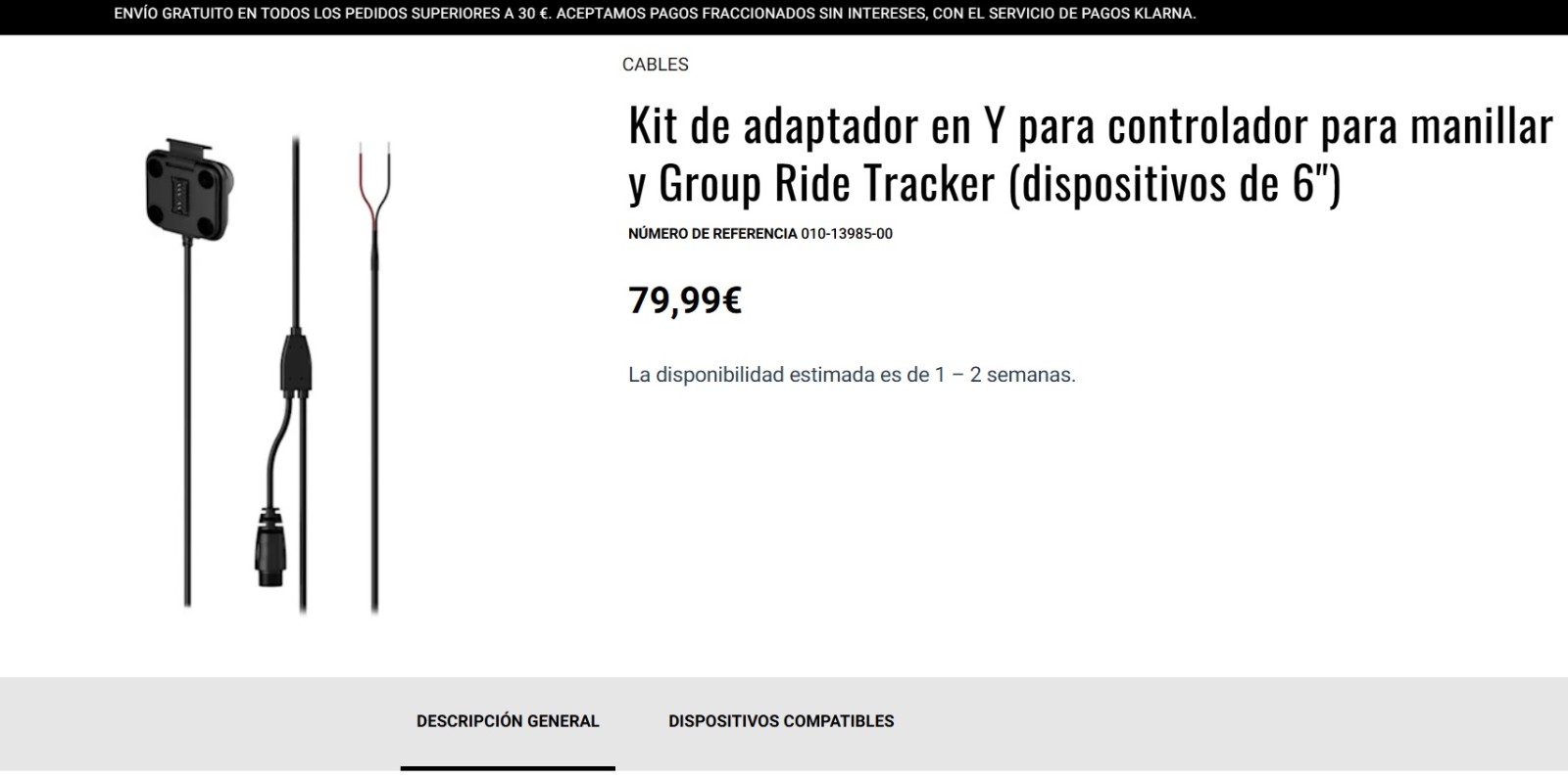

Price for Spain:jfheath wrote: Sat Dec 28, 2024 8:25 am Just answering a question on FB page. Someone had ordered a cable that I didn't recognise.

Cheaper than the other 2 cables, and with the new support included. This now makes more sense.
