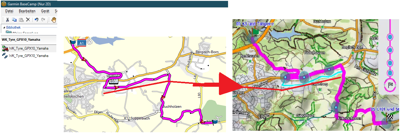

I have already written it in another thread, here again, because my experience / reconstruction of the problem fits better here.
The Tread APP changes planned points!
I have a small example:
1st. Route and track from Basecamp.
2nd. Without Zumo XT2 only imported into the Tread app.
3rd. 1st result: The sharpening points are changed and moved after the import into the In Tread App.
4th. Attempts to manually place a sharpening point so that the route also follows the desired track.
5th. The Tread app also changes this point so quickly that you hardly notice it (see video in attached 20240925_220545.zip)
I find this behavior unacceptable!
If I plan a route (in this example past a Yamaha dealer without necessarily having to stop there) then the XT2 should also take me there.
PNG-Bild (neu).png (594.93 KiB) Viewed 4395 times
WK_Tyre_GPX10_Yamaha.gpx
(34.7 KiB) Downloaded 250 times

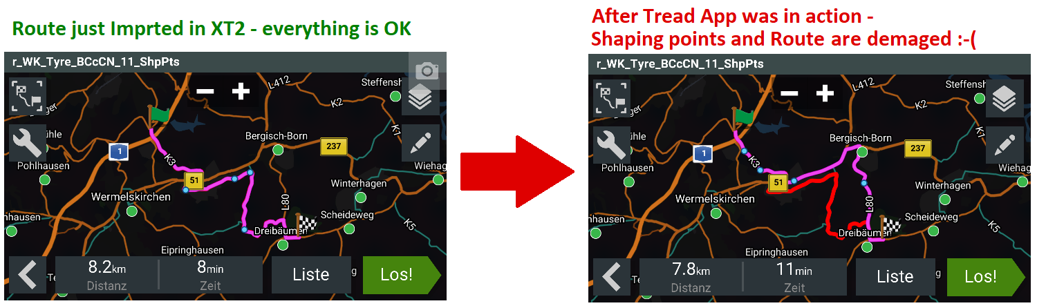

As soon as the tread app is in action, the shaping points will be changend
jfheath wrote: Tue Oct 01, 2024 6:29 pm That is true for:
  • Basecamp produced GPX files
  • BC produced gpx files with the Subclass fields stripped out.
  • Routes from anywhere with start stop and one shaping point
  • Routes from anywhere with Start Stop and two shaping points.
  • Identical route imported into the tread app, exported as a gpx file and loaded in the same way as any other gpx file.
  • Identical route exported as a gpx from MyRouteApp.
It is not true for:
  • Direct Routes - ie straight lines. The shaping points stay where they are.
  • A route with a start, stop and Via points. The via points retain their name and stay where they are.
And sometimes the collaboration with the Tread app changes parts of routes significantly.
So, I have tried to reproduce the experiences as an example.
My issue guide has been created.
The details are described in the Excel sheet “_Tread_Shaping_Point_Issue_Guide.xlsx”.
All files used are in the “_Tread_Shaping_Point_Issue_Guide.zip” file.
I tried routes from another source, which were also saved with Basecamp, calculated there or not, with shaping or with via points and with faster time or direct calculation.
The collection may be helpful.

The issues can already be guessed if you try to edit the routes “only” in the Tread app, because even the smallest changes are enough for the Tread app to make its own interpretation.
PNG-Bild (neu).png (206.55 KiB) Viewed 3938 times
rt_WK_Tyre_BCcalcCN_11_ShpPts.gpx
(153.56 KiB) Downloaded 241 times

Thanks for your comment. It sounds like you are puzzling over this one as well.
It would be helpful if you would report you dissatisfaction to Garmin [email protected]
Give it a clear title, and outline what is happening. Basically, your shaping points are being ignored. Don't give them a way out - they don't support Basecamp, but they do support gpx files. The route moves your shaping point to a different location.
But any opportunity to blame the problem on another product, they will take it. They cannot possibly spend resources looking into odd behaviour when other software is being used.
One thing I have noticed in the Tread App on the phone and on the XT itself is that if you build a route with only Via points (Stops) The route generally behaves itself. Once the route is complete, you can then change the Stops to shaping points. Sometimes the previous shaping points are moved, sometimes not. It seems to work better if you change points against the flow of the route - backwards.
Using the track as a guide is an excellent idea - especially on a small screen where it is necessary to keep zooming in and out just to see where you are on the map.
A route from MRA or basecamp, exported as a gpx file will work and the position of the shaping and via points will remain intact as long as the XT2 is not allowed to synchronise with the tread app. With v1.1 from MRA, there are only route points, so the XT2 will recalculate anyway - but with the XT and the XT2 we have come to expect the route to be recalculated. But my normal rule of putting shaping points to prevent routing along a nearby faster road will still work. Eg one point in the middle of the section, or two points at roughly 1/3 intervals. 'A section' being a stretch of road where it is not feasible to get back to the faster road.
But as soon as the XT2 is allowed to synch to the tread app it seems to ignore shaping points, plot the route using the chosen preferences between the via points, and place new shaping points on the calculated route. Not all original shaping points are ignored though, and I can't work out what it is doing.
Clising down the tread app on the phone seems to prevent this from happening. On the Android, swiping it off the screen does the trick, but it leaves tread able to handle traffic data, weather, messages and roadworks On my ipad if I swipe Tread off the screen Tread is no longer shown as connected on the XT2. But my ipad isn't a phone, so maybe those other things will work if an iphone was used rather than an ipad. ?
