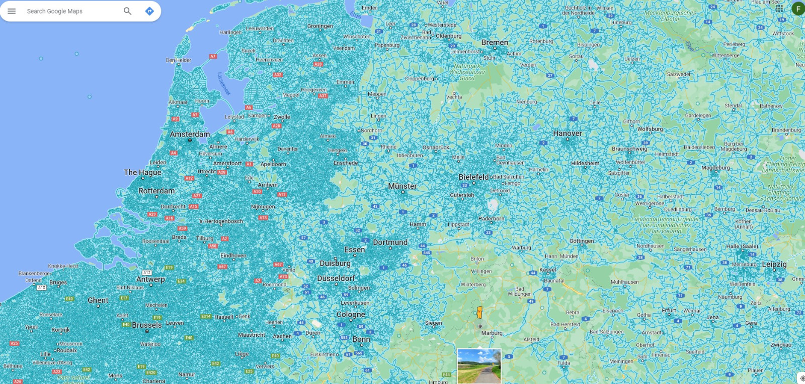

Peobody wrote: Fri Oct 27, 2023 12:18 pm The street view I am referring to is on the Google Maps website. Is that the one that was banned in Germany, and is now poor? If so, that is unfortunate.
Yes, that's the one. But also Google Earth (Pro), they use the same data. This is a picture of the area. On the left you see Netherlands and Belgium/Luxemburg. On the Right you see Germany.
On the right the 'blue lines' (Roads that have streetview) are not so dense.

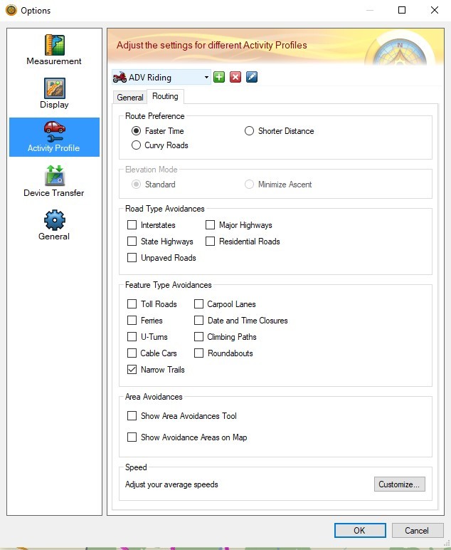

I've come upon a planning challenge that relates closely to the content in this thread. I have a BMW R1250 GS and, up to this point, all of my routes have been on pavement. As such, one of my checked Road Type Avoidances has been Unpaved Roads. I have many routes planned this way. Now, I am ready to include easy packed dirt/gravel and US Forest Service roads in order to open up some new experiences. I understand that changing the avoidances in my Motorcycle profile will cause the recalculation of all my previous routes. I don't want to do that. I thought about two options that might allow me to have a different profile for these new "ADV" trips:
1) Repurpose the Car setting - essentially duplicate my current Motorcycle settings but allow for Unpaved Roads in both the Zumo XT and BaseCamp. I would have to manually switch the Zumo XT to Car, presumably before I loaded the ADV route so as not to trigger recalculation. I understand that it would stay in Car mode on subsequent bootups so I'd need to switch it back to use a route created with a Motorcycle setting.
2) Revise Motorcycle setting on Zumo XT before transferring routes - this would entail unchecking the Unpaved Roads setting in the Zumo XT before transferring the routes. I'd also want to recheck this box before transfer a pavement-only route.
Thoughts on whether this could work?
Thanks to this forum I now transfer Tracks as a check and backup. It would be so nice if the Zumo XT could recognize a custom setting and its associated avoidances.

Consider using a custom route profile in the routes that you want to allow unpaved roads. The settings for doing this are in the route options tab of a route's properties. I think it will make sense once you look at it. AFAIK, the unpaved road choice is transferred. The question someone else will need to answer is whether you will need to enable unpaved roads in the XT so that they will be considered should a recalc occur.

That's exactly what I've done so far. My "ADV Riding" profile differs from Motorcycle only by unchecking Unpaved Roads. Based on my understanding the route would transferred exactly but then would be recalculated because my Motorcycle profile in the Zumo XT does not allow for Unpaved Roads. If I changed this in the Zumo XT beforehand it seems like it should work.

We know that your ADV Riding custom profile will not be recognized by the XT so I believe it will import the route using its Motorcycle profile. That is just my suspicion. Do you know whether the unpaved roads option is honored by the XT upon import of an ADV Riding route? If not, I think a test is in order. Create two duplicate test routes that contain an unpaved road. Use the ADV Riding profile on one and a None profile on the other (create it using the Motorcycle profile and then enable unpaved roads in the route options tab). Transfer them to the XT and see what the resulting routes look like once imported.
