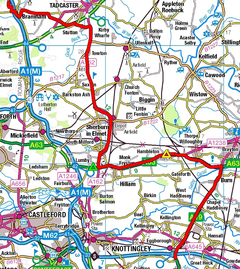

No. I'm saying that what I have observed is that even though the XT is heading for its faster route, if I choose to go my own way, the XT gives up on insisiting that I take its route - much sooner than I expected it to.Peobody wrote: Sun Sep 17, 2023 1:59 pm
Just so that I'm clear, are you saying that a 'fixed' route (eg: 'saved' trip) not only eliminates the RUT issue but also reduces the insistence by the XT of routing on faster parallel roads even if longer distance?
Given its algorithm of heading for faster roads, demanding a U turn is perfectly sensible and correct. Yet my observations are that it gives up quite a long way before reaching the point where my way is to be preferred. It is as if continuing to navigate in the way that I am heading is given a much greater weight than I expected.
Let me illustrate. I have to say this first though: Map Contains OS data © Crown copyright 2020
Click to get a better image
I was taking the red line.
All the way down, the XT was taking every opportunity to get me to take the motorway - the A1(M) and then the M62 East.
At no point on this run did it ask me to turn round and go back when I carried on my red line.
But it still wanted to take me SW to junction 43 from Towton, WSW on the yellow road from Sherburn, South at the Green Triangle on the A162 to join the A1(M)
As soon as I turned East on the A63 at the green traingle, it gave up and navigated me east.
Yet I know that if I stop at the side of the road and ask it to take me to the same destination (which is 5 miles due south of the letter 'E' in Knottingley at the bottom of this map), the XT will want to head me west to the green triangle.
The balance point here is the yellow triangle - a village called Hambleton. If I set my destination when I am at the east side of the village, it heads me east. If I set me destination when I am parked on the west side of the village, it heads me west.
Yet - having just passed the green triangle, it has already given up on the motoways and is taking me east. 4 miles before the yellow triangle balance point.
I've seen similar behaviour in other places - but this particular section I had tested throughly when it was displaying RUT behaviour - and this result really surprised me - I had decided that I knew what it was going to do. I was wrong - in a good way. I had to check that I hadn't disabled U turns. No - they were allowed. It didn't use them.

This clarifies it for me. Thanks!jfheath wrote: Sun Sep 17, 2023 3:31 pm No. I'm saying that what I have observed is that even though the XT is heading for its faster route, if I choose to go my own way, the XT gives up on insisiting that I take its route - much sooner than I expected it to.
