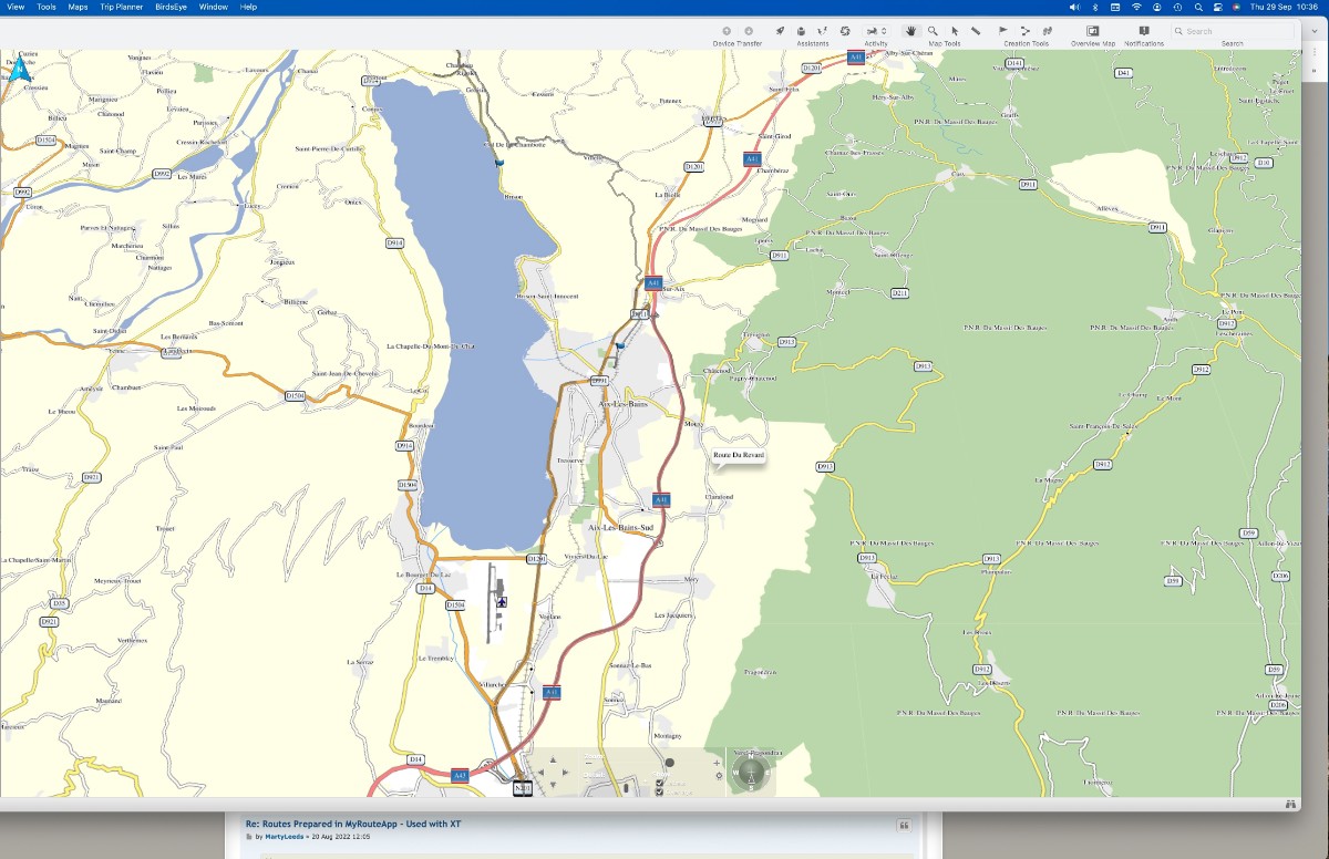

I am back in Blighty and thought I would update you lovely people with my experiences.mad-dawg wrote: Thu Aug 11, 2022 9:40 am Thanks for the report FF
I will give it a test, if I can ever find a front tyre for the bike![]()
The big test will be in September in Germany, they do like to close a motorway and give you no diversion to the next open junction.
Apart from the first day route from Rotterdam to Trier which I planned at home and sent to the XT, all the other days were planned the evening before in MRA on an Ipad.
Each route was sent as 1.1 track/POI, and recalculate was on and the route in MRA had a start and end point with shaping points as required to follow the planned route.
Most days this worked really well, if I went off route I got the U turn thing and then the XT gave up and plotted a route to get back on the original.
Except! on one day travelling from Barcelonnette to Aix-les Bains it acted the fool. When I got within about 30K of Aix it wanted to follow the planned route on the Peage, I being a Yorkshireman decided to follow the signed non peage route to Aix les Bains.
The XT repeatedly demanded U turns for the rest of the journey, trying to force me back to the motorway, even when I got to the town and pulled in a carpark to check google maps to see where I was in relation to my hotel. (About 500m away)
At this point I had travelled 30K north with the XT saying that I should turn round and travel 30K south to join the motorway and then travel about 40K north to Aix les Bains. There were no shaping/via points forcing this and I just muted the voice instructions.
I checked the track in Basecamp yesterday and it shows the planned route and the actual track of the diversion I took, I have no idea why it was sending me on a 70K diversion when the end point was 500m away.
Anyway, thank you John for your help, I now have a process that works most of the time.

Hi @mad-dawg , welcome back. Hope you had a good trip. The last time we were able to tour in Europe was in 2014, when we rode down through France to do parts of the Tours des Grandes Alpes and Route Napolean. A really sepctacular 2 weeks. The second day in France took us to Annecy - about 20 miles north of Aix-les-Bains, and for us the following day, the start of the alipne passes. I thought that we had actually been through it - but looking at my satnav logs we didn't. It must have been the town that was on all of the signs.
Anyway - I am interested in your observations. I wonder if you would mind sending me your route and your track (if you have them) for that day.
The reason I am interested is that I have seen this many times before. Once it gets into a cycle of taking you back - it can never recover. The reason seems to be that it is taking you back to the point of last instruction that it gave you - that being the place where you left the route. Not the original route, but the one that it modified to get you back.
