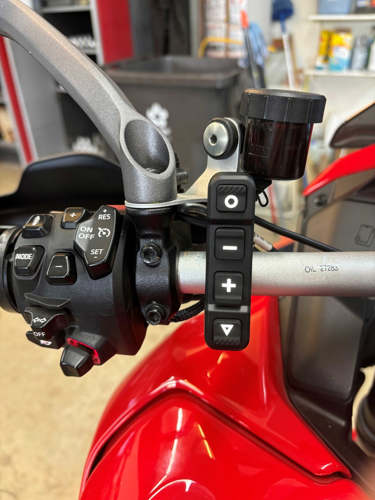

Got everything installed and working today. Power cord comes with about 10 feet of wire which was way too long for my setup and difficult to stow so I cut off most of it. Controller works quite nicely and as advertised. When you start up the bike/nav it takes a few moments before the controller comes online.

Here are some pictures. Don't know why they came out sideways?

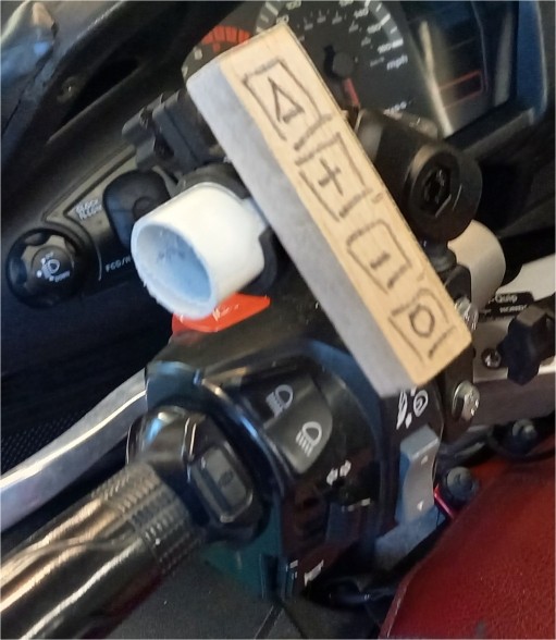

Today I put it all to good use to see whether the device would fit OK on my ST1300.
So a ramball mount now bolted ontop of the clutch lever mount brackets.
A short RAM joining extension
A sawn-off RAM ball mount (originally intended for mounting on the clutch/brake lever mounts.
A piece of plastic pipe - which easily deforms in boiling water.
A piece of balsa wood and your very useful measurements
A handlebar clamp which I think came with the bullet cameras that I bought years ago.
et Voila !
Handlebar Remote Mockup2.jpg (84.33 KiB) Viewed 7646 times
Still with plenty of leeway to allow change of position - but I am pretty certain that this mount position will work OK. (it doesn't look like it, but there is plenty of room for my thumb to get at the headlight dip/main switch without knocking the balsa remote).
Handlebar Remote Mockup2b.jpg (67.38 KiB) Viewed 7644 times
Lots of tidying up to do when I get the real thing - and the tube needs to be secured properly and I'll make it shorter - once I can be sure of the best position. As it is, I can reach the bottom three buttons with my thumb without lifting my hand from the bar. The top one requires a bit of hand movement. (Big hands)

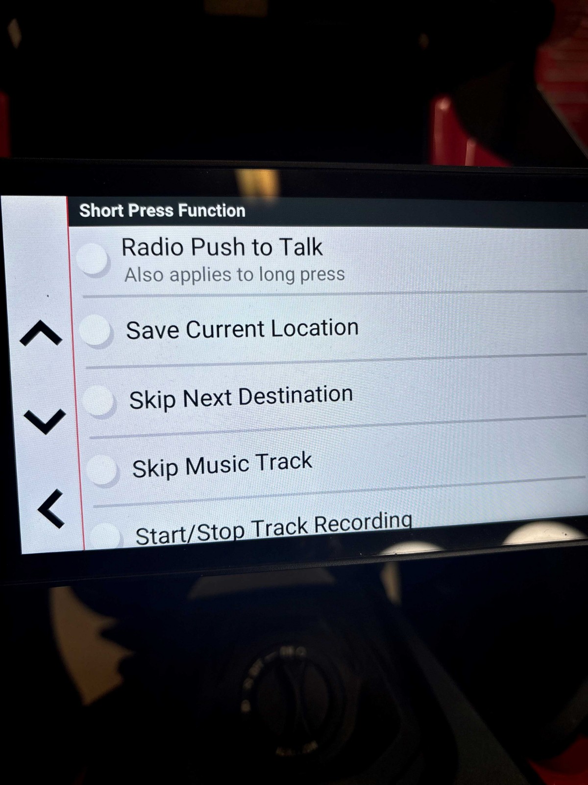

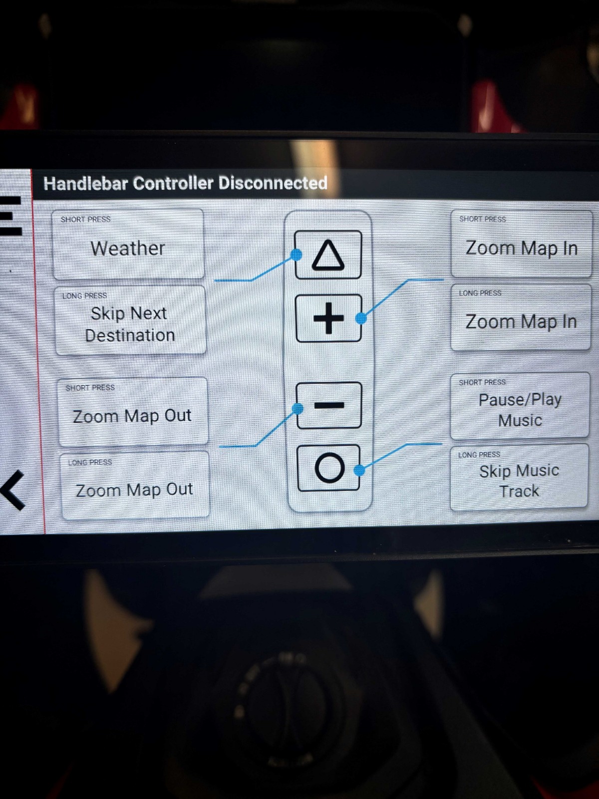

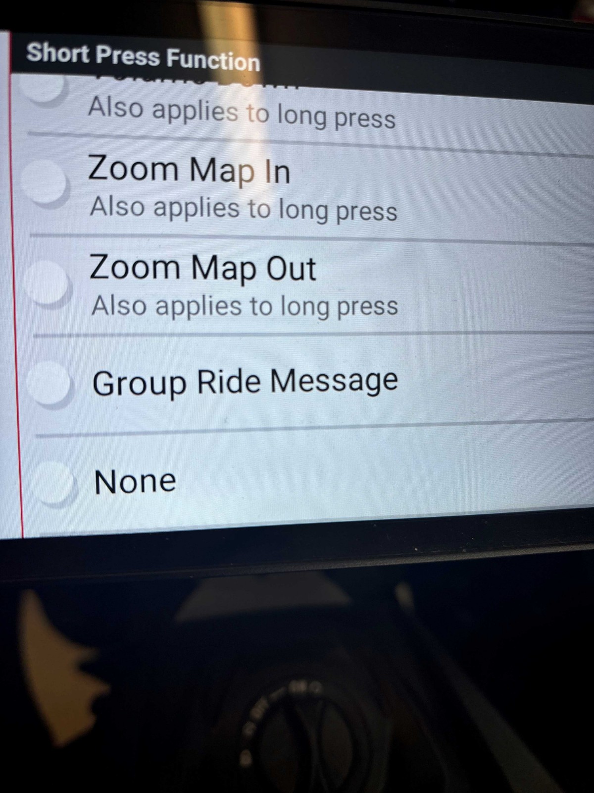

From your Short Press screen shots, some functions - eg Zoom out - say that they also apply to long press.
Does that mean that long press on that particular button is not available for a different function - or does it mean that Zoom Out is also available on the list of long press options ?

It just means I pressed the option to set the short press function. Most all of them are available as a long or short press. I was just trying to show the setting options available.
