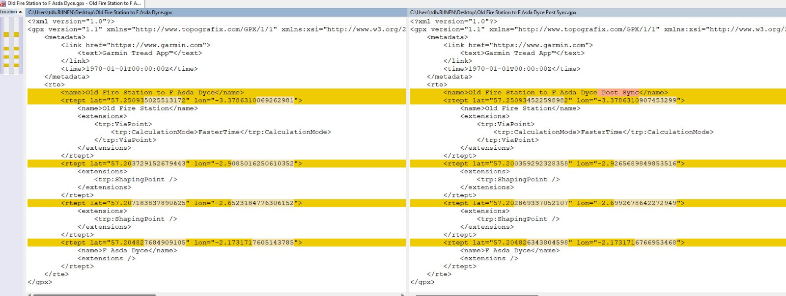

smfollen wrote: Tue Oct 29, 2024 1:02 pm Oop North John They do try to use Basecamp as an excuse whenever possible. You just have to tell them that the issues occur even when Basecamp is not involved.
Just produced a route on Tread allowed the XT2 to sync to it, and surprise surprise the shaping points move. :roll:
GPS files are below.
Sent the before and after plus pictures of the XT2 screen to them.
I think my reference is: Ref:28573330K0
Old Fire Station to F Asda Dyce.gpx
(1.01 KiB) Downloaded 268 times
Old Fire Station to F Asda Dyce Post Sync.gpx
(1.02 KiB) Downloaded 263 times

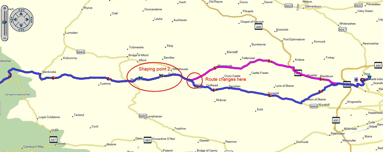

I dont have an XT2 and cant contribute much, but I was interested and downloaded the GPX files. There are 2 things that I dont quite understand. Apologies if it's not relevant.
1) Not only the 2 shaping points are moved, but also the start and end point. Just a little, you may not notice it in Basecamp. But Thread changes not only Shaping points! See the compare screenshot.
2) The 2nd shaping point is moved a bit earlier in the route. (more east). But I dont understand why the resulting route in Basecamp should be different. The point where the routes are different are after the 2nd shaping point. May be irrelevant.

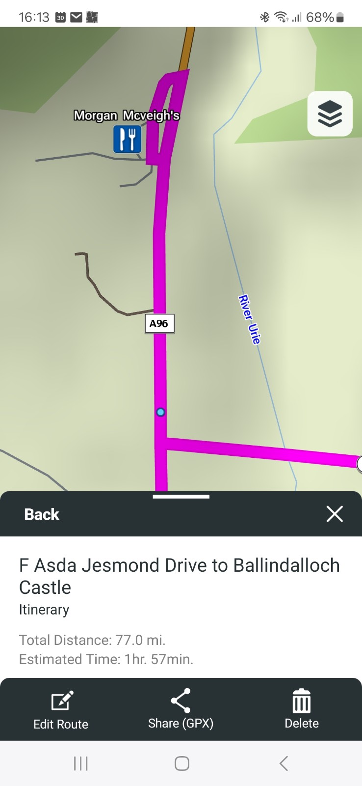

Played with producing a route in my XT2 and then syncing it with Tread. The shaping point moves, but the route still follows the logic of where it was prior to the sync! Shaping point was near to my way point of Morgan Mcvies.
Garmin support updated with this gem :lol:

FrankB wrote: Tue Oct 29, 2024 8:33 pm 2) The 2nd shaping point is moved a bit earlier in the route. (more east). But I dont understand why the resulting route in Basecamp should be different. The point where the routes are different are after the 2nd shaping point. May be irrelevant.
I think that the route changes are due to Basecamps superior routing logic, which seems to avoid the faster roads problem that afflicts the XT and XT2.
The northern routing is about a minute shorter if the start point is before the junction near to Tough.
