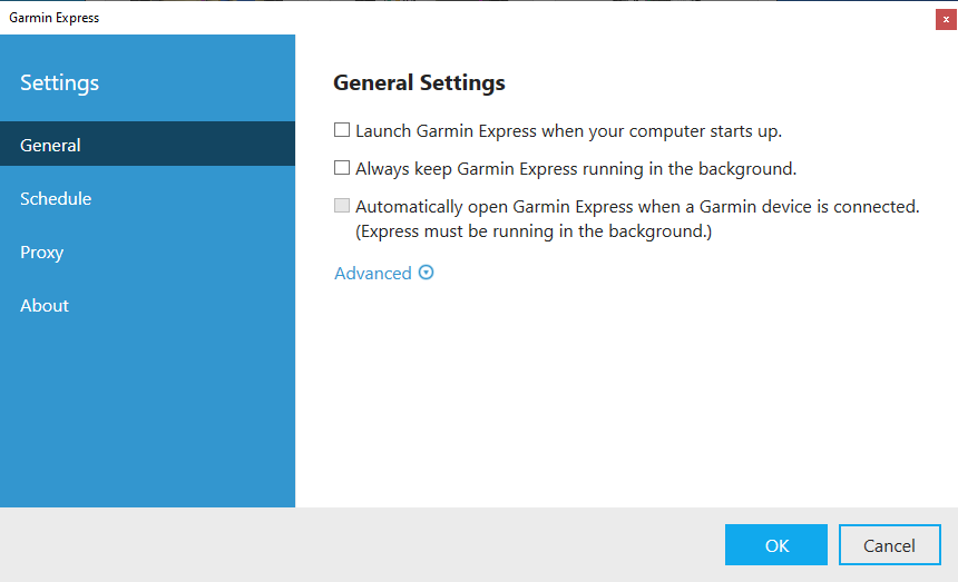

To make Express not load up on startup:
1. Load Express
2. Click the Gear Icon at the top to get this screen:
Express Screen.png (31.71 KiB) Viewed 3326 times
3. Untick all of the boxes.
Close down Express.
You used to have to do this every time that Express was updated. I haven't seen that happen for a while - but I use a PC, so if there is an issue in future, just check that Express hasn't been reset to keep running in the background.

I jsut checked, these are still unchecked,...
So that should work...
