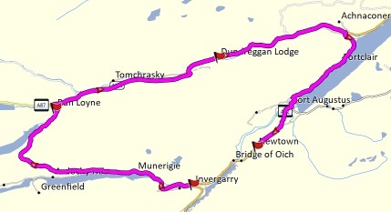

I chose a route which I knew could not be altered - no matter what avoidances or road types were ticked in the Basecamp settings.
A circuit where no other roads could be used. I wanted to see if there was any significant difference between the gpx file that was produced for each of the 3 routes by comparing the gpx files. If the calculated route was different each time, I would not be able to spot the avoidance data - if it existed.
BC FtAug Route.jpg (22.12 KiB) Viewed 2187 times
The only difference in the 991 lines of the gpx file was the time, the route name and the 3 lines describing the profile name used in Basecamp to create the route. This name is used to switch the Zumo into the correct mode when tthe route is loaded. The first route had the three line, the other two did not.
This wasn't just a casual glance - I loaded the three files into a spreadsheets - made sure that the corresponding lines aligned correctly and got the spreadhseet to do comparisons between the text on the same line in each of the three gpx files. Everything was identical apart from the 3 things that I have mentioned. If the avoidance info was being sent to the Zumo with the route / gpx file - there would have been differences between at least two of the routes. The customised routes were absolutley identical except for the name and the time.
I still reckon that if the routes are behaving differently when changing those settings after being calculated by the XT, then there has to be some other reason for it. I can think of many possibilities - and it is why - when testing RUT behaviour, I had to clear out my XT and perform a complete system reset before each separate test.
