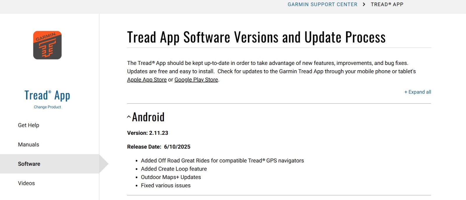

New Tread App version for Android:
2.11.23 (29 may 2025).
- New look of the collections menu
- If your android has large font, now WP and place names look bigger
- Now when you generate a route on the map, you have the option to "create loop from this location."
- Your Garmin account is now visible in the menu, and you can log out or open a different account.

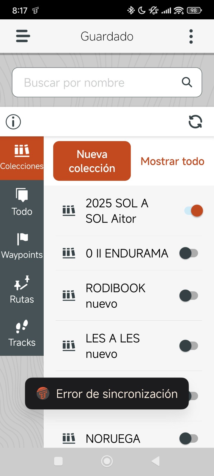

- I'm getting a sync error (Tread App), even though just yesterday the previous version was syncing fine. One step forward, two steps back. Could someone confirm if it syncs properly with this version?

It seems to be syncing items fine, but the sync error message keeps appearing on the Tread App screens.
The time and date of the last sync also don't appear in the Tread App (it does on the XT2). It seems to sync well and faster than before. Have you noticed that @jfheath ?
