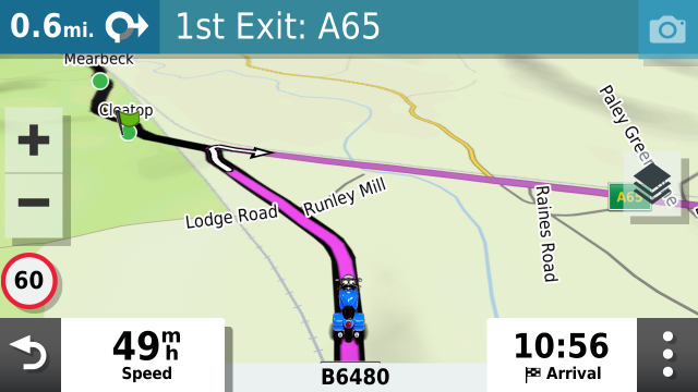

1. The track is only readily visible when it is not hidden (covered) by the route line. When a recalc changes the route, you will see the route line go one way and the track line will go another.
2. Track width and track color are important. I set width to Wider and color to Black.
3. When you enable a track to show on the map it will be visible when viewing the map without any route loaded. You can use it to help in determining the width and color that works best for you.
3. Themes affect how things are displayed. I played around with some of the options as well as attempting to make an acceptable custom one but ended up returning to the Garmin one. I don't recall if I tested them with tracks but if you are not using the Garmin one you might want to change to it and then test a track display.

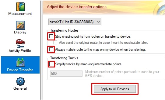

Skipping a Via Point definitely does not remove the shaping points - but I think I know what it is that you are seeing.
There is an option in Basecamp which you need to set :
Edit -> Options -> Device Transfer
Untick all of the checkboxes. Then select 'Apply to All Devices'.
If you don't do this (some are set by default when Basecamp is installed), then when you transfer the route to the Zumo, it only transfers the Via Points. It doesn't transfer the shaping points. The route is held in place by the ghost points. But if you ever allow the Zumo to recalculate the route, it only has the Via Points to work with. And it calculates a route just using the Via Points. So probably htis is the first time that you notice that the shaping points are not there. I'm pretty sure if this is what is happening, the shaping points will not have been there in the first place. You just never noticed, because the route was going through the locations where you had shaping points.
Check your route in the Trip Planner App. The shaping points are shown as blue discs on the map and in the Trip Planner list of points. I think you may find that they were never there in the first place.

Regarding track visibility - you can change the colour of tracks and make them wider from the XT screen. Where exactly this is depends on whether or not you have Garmin Explore set up. This link points to the first of two pages on how to do this with and without Explore set up.
app.php/ZXT-P57
The above method changes the width of all tracks on the map, so if you want to show a track that is underneath a route, you may need to edit the theme with a text editor to make the track slightly wider than the route. This isn't as straight forward as I have made it sound - but I have made a theme that achieves this if you want a copy. You put it in witht he other Zumo themes and it appears on the list to select when you want. THe link above shows a screen shot of the green track peeping out from under the magenta route. Black stands out much better, and it is very obvious when the route and track head off in different directions.
Peobody wrote: Sat Apr 29, 2023 1:26 am 1. The track is only readily visible when it is not hidden (covered) by the route line. When a recalc changes the route, you will see the route line go one way and the track line will go another.
The first half is where my trouble lies, this is NOT TRUE!! The track line is so fine and narrow, it simply can't be seen unless I touch +++++++ to zoom so far in so as to make the map unreadable beyond 200 or so ft around me. What good is a map when you can see only 200 ft at a time?
The second part I get I see when zoomed way, way in.

If you are having trouble with XT navigation (and who isn't ?) then there are two reliable catch-all things that will get you out of a pickle.
One is to have the track displayed. The other is to disable U turns. I don't like U turns disable, because in Yorkshire, it can go 15 miles without finding an alternative place to turn round without doing a U turn. It then doubles you back to do the same 15 miles again. I prefer to know that it is wanting to navigate me a different way by allowing U turns. Although irritating, it inform me what it is up to.
So for unknown areas the last thing that I do in Basecamp for the XT are:
Recalculate all of the routes.
Create a track for every route
Transfer all of the routes and tracks to the XT
With a different theme - I use JH United Kingdom or JFH Garmin, which are my variations on the provided themes, the track becomes visible from underneath the route. With the track colour set as black and the track width (for all tracks) set 'Wider' ,as opposed to 'Normal' or 'Widest', I can see the black track underneath the magenta route, and the deviation is very obvious.
It's not perfect - sometimes the track displays really wide - when the map is redrawing, but only for a moment or two. It is perfectly good for navigation.
Let me know if you want a copy - I cannot post it here - the system will not allow it.

2) I have always had the boxes in the Transfer Mode Options unticked. For some reason the maps one is now. I unticked it.
