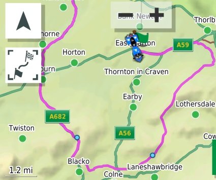

I have done a fair bit of testing with v2.90 firmware, and I have to say that Closest Entry Point is the best that I have seen this feature operate to date.
But I have tested v2.90 before, soon after it came out, and I was less than impressed. This may have been circumstantial, but worth noting is that since that test I have used Garmin Express to update 3 files which I believe should not affect the software function. Text Translation, Cyclopse updates and the like. Also Garmin Express needed an update twice on consecutive days - I have V 7.1.2.0, installed earlier this week. I just loaded it to read the version number and a new version 7.1.3.0 is now avaliable.
After those updates I tried these lengthy tests and Closest Entry Point was working (almost) very predictably).
I used Basecamp to create the route and to transfer it Via USB cable to the Zumo XT.
What I found was:
The CEP function attempts to navigate the rider from the current position to the closest point on the route.
This is irrespective of location of Shaping Points or Via Points. It picks a point on the planned route and heads for that
It then continues along the planned route follwoing the shaping points and Via Points in the correct order.
It ignores any Shaping Points and Via Points that are behind the point of entry.
I looked for, but found no difference in behaviour for any routing point that was first created as a Waypoint, or a routepoint that was 'dropped' into place using the insert tool or the route tool. This odd behaviour had been observed in a previous version of the XT's firmware.
One unexplained anomaly
On a few occasions, the CEP function calculated a perfectly sensible route, but it did not head for the closest route point. AFter much messing around, it seems that when this happened, If I forced a recalculation of the route by (say) ticking / unticking U-turn as an avoidance and loading the route again to select the closest entry point, it produced a correct result. It didn't matter whether I ticked or unticked it, as long as it was changed so that the route recalculated when it was loaded. If I subsequently set it back to what it was, I still got the correct route.

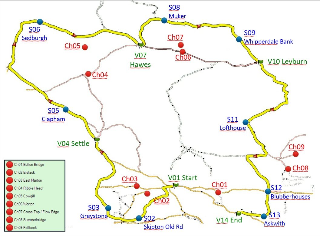

I have a simplified image of my test route shown below.
There are 5 Via Point (including start and finish) and 9 Shaping points. They are lettered V or S (Via, Shaping) and then numbered consecutively
eg V01 S02 S03 V04 S05 ... etc.
There are also a number of Check Points - places to position the bike to test what the satnav will do when the route is started from there and Closest Entry Point is selected. These are labelled Ch01 Ch02 Ch03 Ch04 ......etc. I have created these as Waypoints so that they are plotted on the map, but do not appear in the route itself.
All of these along with the shaping points, via points and the route itself are included in the attached gpx file.
(Modified from the original gdb file - 30 Aug 2020)
The route was created using City Navigator Europe NTU 2021.10
What I found was:

Simplified Image of the Test Route

I am aware that waypoints are not perse part of a route. I called them either via-points, those are the red flags on the XT, or shaping-point, blue dots on the XT.
The 'CEP Route - All Waypoints' that you posted only has 'red flags' on the XT. ('Alert on Arrival' in Basecamp).
The route I posted earlier had just 1 'red flag', the hotel, all the others were 'blue dots'. ('Dont alert on Arrival' in Basecamp).
I'm convinced that that makes the difference with the 'Closest Entry Point'.
I only used the terms hard and soft waypoints because that's what they are sometimes called (in the Netherlands). Sorry for the confusion I may have caused. Please bear with my, i'm not native English!

No, my apologies. I hadn't noticed your nationality flag, and certainly hadn't spotted that English isn't your first language !
The route I posted is indeed all waypoints. That is, I created every single point as a Waypoint in Basecamp, using the waypoint 'flag' tool. These appear in the favourites list on the Zumo. I then built the route around all of those points. I then made the S points into non alerting shaping points. The V point i kept as alerting Via Points.
I posted the one that was made with all waypoints because they keep their name when they are transferred to the Zumo. Other points do not.
Now if yours is showing all flags, then either I have posted the wrong file - an early version of the route, or there is something else going on. I will check that and repost it if I have made that error.
Once that was created, i created another route using the same 5 Via points, but using the insert tool to drop shaping point where the original waypoints were for the shaping points
Every test, I performed twice - once using the route with shaping points that started life as shaping points, one using shaping points that started life as Stored Waypoints. Through every test, both routes produced identical results.
Now since I received my Zumo XT, I have been trying to work out what Closest Entry Point. V2.30 I found to be ridiculously bad at finding the closest point of the route. It made an effort but it seemed to do some really unpredictable things.
V 2.50 came to my machine in two upgrades. I upgraded it once, and the following day another 2.50 upgrade was available. This worked really very well. But before that, my test seemed to suggest very strongly that CEP was in fact aiming for the Via Points. Not the shaping points. Unless the shaping points were created as waypoints before putting them into the route ! It seemed to suggest that perhaps the terms waypoints, via points and shaping point used by the programmers were maybe different from the same terms defined on Garmins website.
V 2.60 seemed to get it all wrong again, and I stopped experimenting. When I first tested v2.90 it seemed to work reliably, but it only ever selected the closest Via Point. Never a shaping point, not even if it had been a Waypoint when it was created, and then added to the route.
There hasn't been an upgrade to the software since that test - it is still on V2.90.
But since then I have:
Installe2 2 new versions of Garmin Express (I update via Usb cable, not by wifi).
There have been 3 other upgrades of 1-2 mins, supposedly to do with translation, text and cyclopse.
I have cleared out all of my data - using the option on the hidden system menu ****
I have restarted the Xt from cold a few times. On one of these, after downloading some small update, it gave a message saying it was installing software and then restarted.
I dont remember the order of these things, but subsequently my closest entry point tests worked perfectly as I expected. With a couple of small glitches whic I solved to my satisfaction.
*** hidden system menu. On the navigation map display, press the speed button. On the next display press and hold for 10 secs the speed in the circular display in the top, middle part of the screen. Theres all sorts of stuff in there, including the ability to wipe out data and reset the machine.
I'll check which file I actually sent ........ I'll be back .
Ah - that's interesting. I Posted the correct route with Via and Shaping Points. You received one with all Via Points.
What ? Why ?
Well, it appears that if I export the route and routepoints as a GDB file, when you reopen it, all of the shaping points have been converted to Via Points. If I export them as a GPX file, that doesn't happen. How strange ? Sorry about that - I didn't know that happened.
I haven't changed any of the route that I exported !
I've replaced the gdb file in the post above.
Here it is again.
Probably best to recalculate the route in Basecamp before transferring it.
